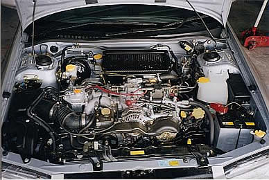

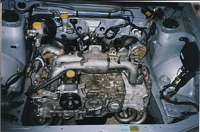

This is the standard engine bay only 80 Kilometres old. Keeping the engine bay tidy was the aim with day to day driveablity in mind

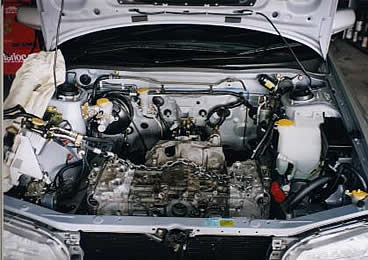

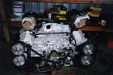

Dummy Fit of the EJ25 Block into the engine bay to workout where and how to fit the twin GT 28 Garrett Ball Bearing Turbos.

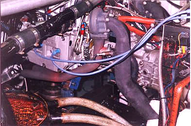

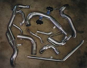

Custom made twin turbo extractor system and turbos are in place. Pipes have been custom made locally by Custom Exhausts in Brisbane Queensland, using aircraft grade steel and precision welding for extreme temperatures.

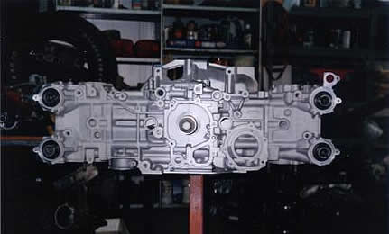

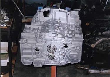

Assembled EJ25 short motor. It has been closed decked. Fitted with forged pistons, billet steel conrods, a nitrided crank and a fully balanced bottom end

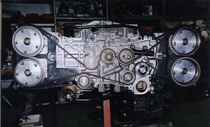

This is the assembled long motor. It has Race Master port and polished cylinder heads by JHH Engineering
The timing belt system is fitted with adjustable Cam gears

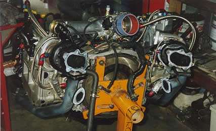

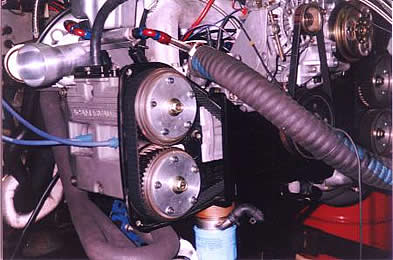

Both turbos and manifolds fitted and coated by HPC

Highly polished Aluminium Intercooler Piping designed by Robin at PMS and built by Custom Exhausts Brisbane
Almost finished, The pipework when placed in the cars engine bay is amazing, a show quality finish with the performace to match.

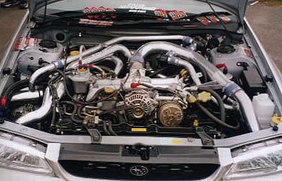

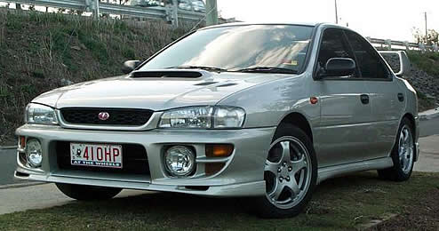

Finished product. Ready for the Chassis Dyno and Development work.
