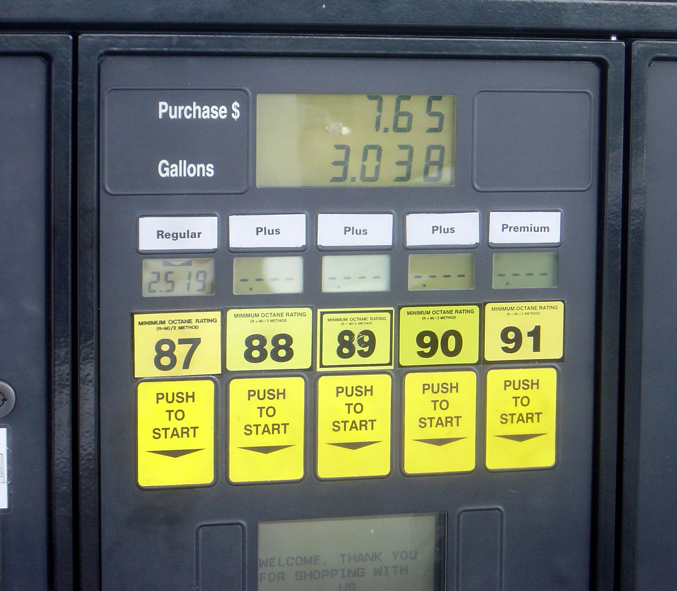

There are a few places where the above is not true - in mountainous regions. There is less air pressure and hence, the octane of fuel will be lower in those areas. I am told that there are some parts of USA where the available octane is RON 87-89.
In USA, they use AKI and not RON.
According to Gasoline - Wikipedia, the free encyclopedia:
In the US, octane ratings in unleaded fuels can vary between 86-87 AKI (91-92 RON) for regular, through 89-90 AKI (94-95 RON)
Btw, alot of people when see the following photo of the fuel octane rating of a gas pump in USA thinks it's in RON. It's actually AKI
