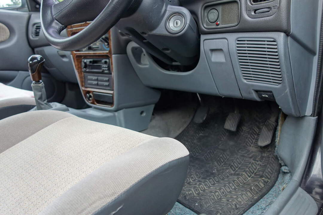

Btw what car actually do you drive? If the pedal position is not nice where the distance between brake & gas is too far apart, and/or the height or level of the the 2 pedals is also too different, then it's a lot more difficult to do it smoothly, for example Toyota Avanza. You may want to try some pedal kit accessories which widen up the pedals and hence can make them closer to each other. Some pedal kits have adjustable extension on the bottom right of the brake and the bottom left of the gas pedal (if not mistaken like Razo brand) hence makes the distance so much closer and easier to heel & toe.
Proton Wira 1.5 4G15.
Here's a picture of the pedal. Sorry that it is slightly blur as I got the wrong camera focus.

Yup, like I suspected, they're quite far apart to start practicing especially if your feet also not big. Better buy some pedal extension kit like below, those should help a lot.

Another thing is better wear shoes.
these things do help.....
if u do wana buy a pair and you always drive barefoot.... i have a tip, make sure its not metal... your feet will get burnt every time you park under the sun... not fun...
https://www.google.co.id/search?q=r...KHdv2ALIQ_AUIBigB&dpr=1#imgrc=YnuOoOhUIKklJM:
https://www.google.co.id/search?q=r...KHdv2ALIQ_AUIBigB&dpr=1#imgrc=lTAsYw2NXe_oMM:

These pedals are needed to make it easier to perform heel toe technique right? Is it really needed for rev matching (without braking)?

I don't drive barefoot. Never tried that. Normally I wear sandals or normal Nike shoes.
haha i guess it does help to a certain degree. If your legs are 'dexterous' i guess anything would do. Stock pedals usually rubbery, i find its not so easy to slide around. With these, the 'tapak' is bigger, easier to reach the pedals and the material makes it easier to slide about. long as the heights are about the same, i guess it does help.
