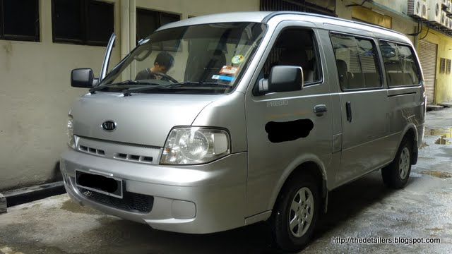

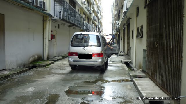

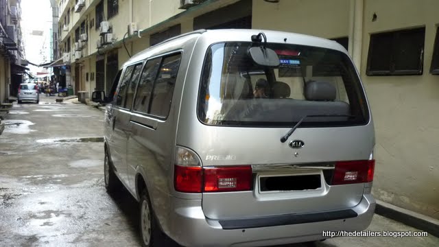

pic from a far
the famous pit stop lane

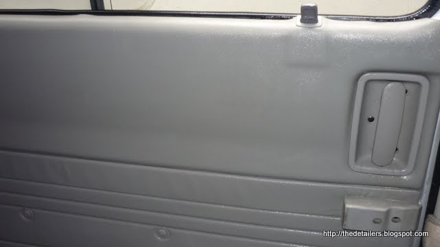

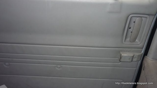

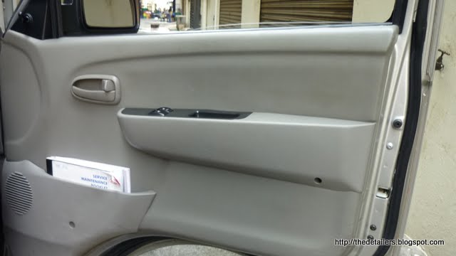

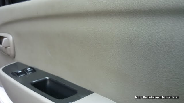

before

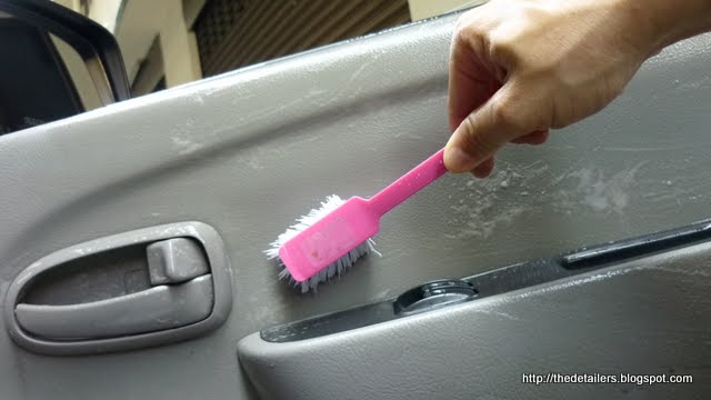

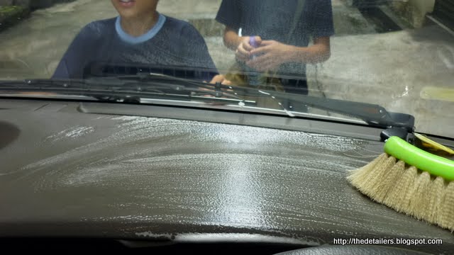

cleaning begins with OSREN MPC 10:1 dilutions

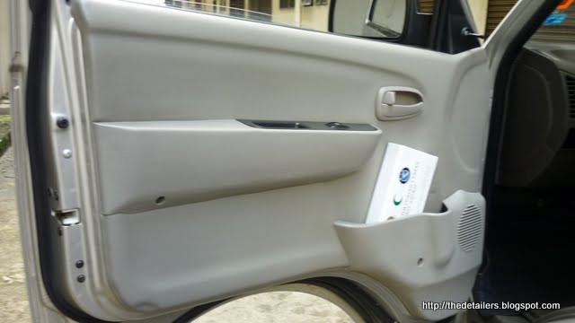

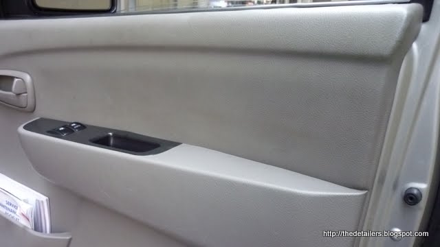

before

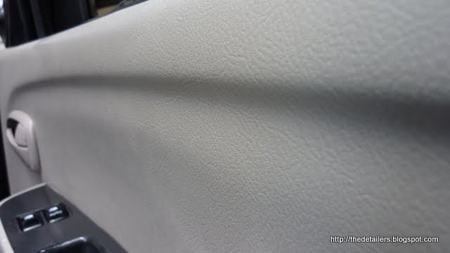

after
ta da the left side panel

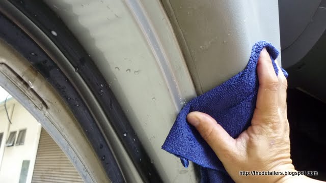

cleaning
rinse away

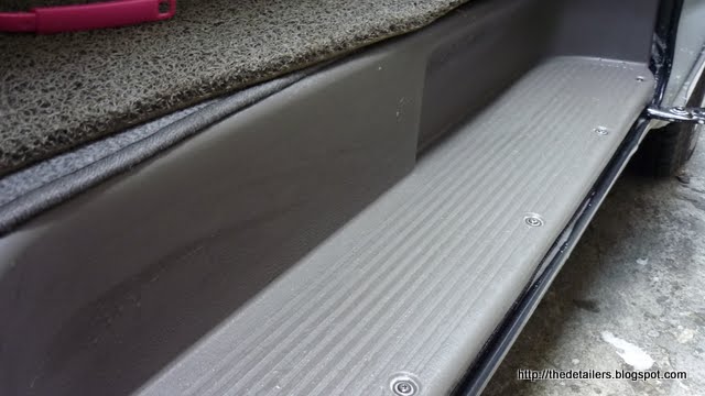

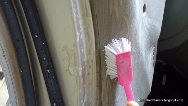

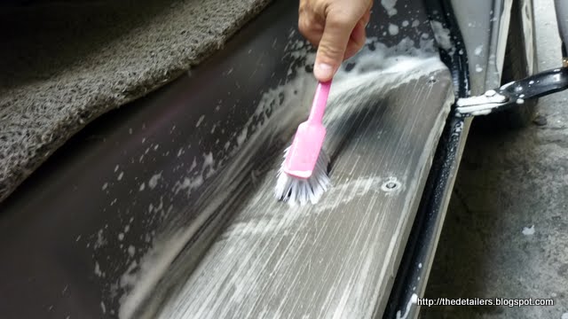

brushing the most abuse area...side steps...vinyl...OSREN MPC

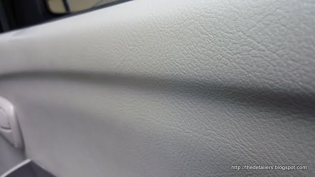

ta da

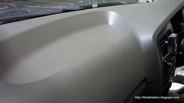

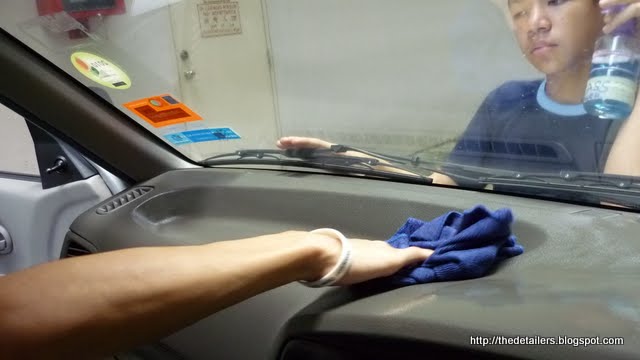

wiping away rinsing with damp cloths

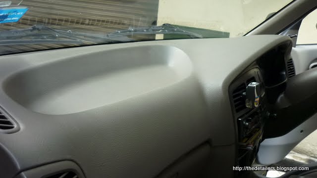

now a clean dash awaiting to apply dressing for protect..UV coated dash

my team members...thadeus on all vinyl parts
