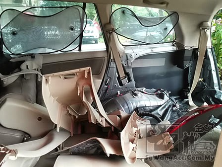

The rear cooling coil is covered by dust and found leaked
The rear air-cond unit is dismantled from the Toyota Innova
