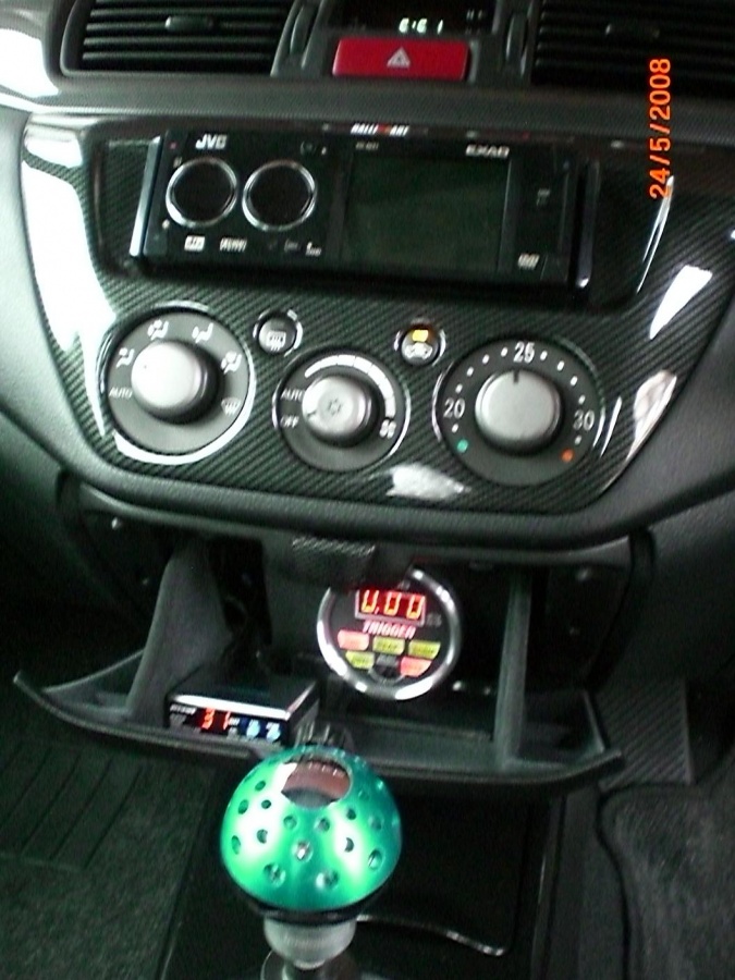

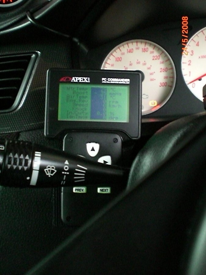

Today, I notice something in middle trays, I press the on button and the performance totally different from last drive. When I press the oil pedal, the car seems to jump from the start. (It panic me for a while. He He He)
For sure, from this moment onwards, I Love EVO.
Beside this, I still find some other things in side my car. Can anyone, tell me how to use this all?

Well seems like your car have and aftermarket ECU(power fc) you dont disturb that as i believe its been tuned already. Cant really see the item in the intray but looks like a/f ratio meter to me.
6 speed? your gearbox has been changed to E8 i assume.
Pivot speed delimiter on the left - To eliminate the speed cut & digital speed readout in Kmh.
Sard trigger boost controller on the right. PEAK= press this for ur max boost history. BST1=Boost 1 for lo boost, BST2=Boost 2 for Hi boost & SCRM=scramble button for Higher boost lasting for a couple seconds. R u sure it's an E7...the centre panel looks like an E8. Hide the Power FC commander so that no one fiddle around with it & screw up ur settings. How much did u pay for this car?

from what i see, you have a nice ralliart carbon fibre DIN cover, and a ralliart speedometer. these two items already total for about RM5-6k for a new set.
with the Power FC and boost controller, i believe your car is already tuned and set in a proper way. if u in doubt, send it for a dyno and at the same time you can get opinion from the tuner for more info on your car.

I think u manage to use the high boost or scramble boost button, so that u got a totally new feeling abt the car power!!! On the 2nd pic, it show that your car have got an Apex'i Power FC ECU, which is a very good tuning unit for your car...
