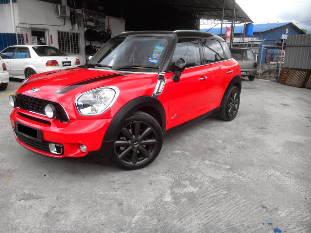

Upon arrival, the car was given a 3 hours wash and thorough clean for paint inspection.

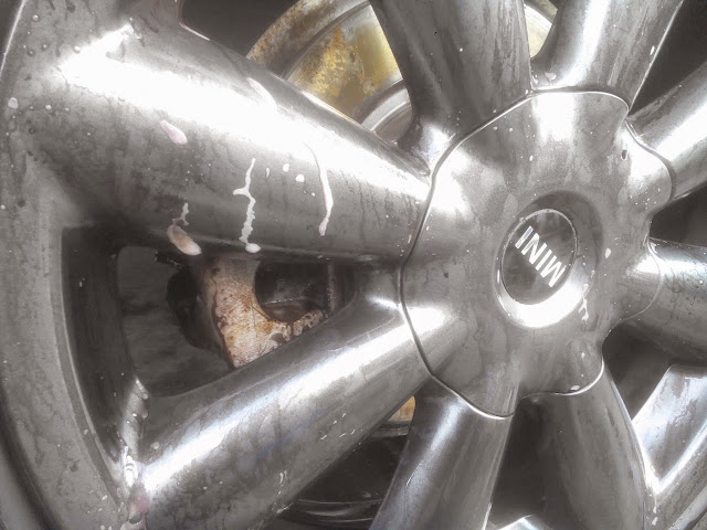

Wheels were washed with Osren Multi Clean, followed by a brief soak in Iron-X to remove any iron deposits and caked brake dust.
The paint was clayed to remove any light surface contaminant such as tar, minerals and traffic deposits. As one can see, the tar spots on this car was not removable by claying (black spot in picture). A heavy duty tar remover was used as an alternative.

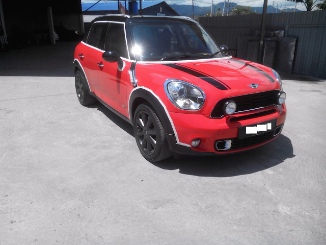

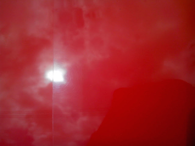

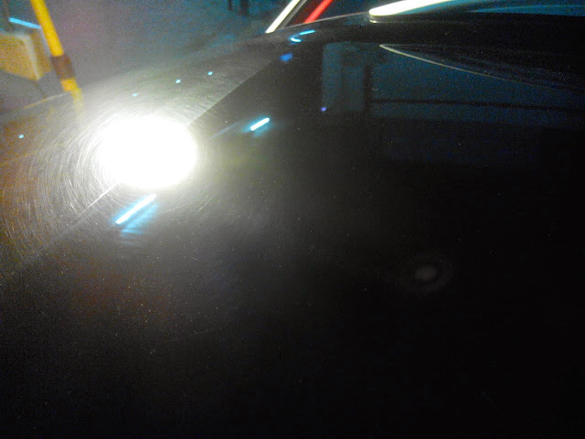

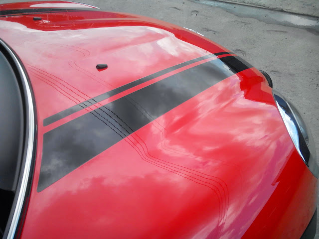

The car was then inspected under sunlight for paint defects. Note the slight pink hue of the paint - signs of paint oxidation.
Swirls and random deep scratches were abundant.

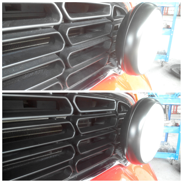

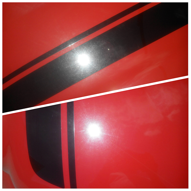

Treatment was 4 passes of Osren Active Polish 34 on wool pad, followed up by 3M Machine Polish and 3M Ultrafine Polish on polishing pad. Extra time was required due to the hard nature of the ceramic clear coat.
A 50/50 shot of before and after (first step) on the bonnet.
A 50/50 shot of before and after (first step) on the roof

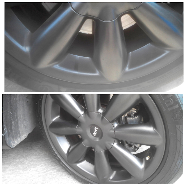

Tyres were applied with protectant

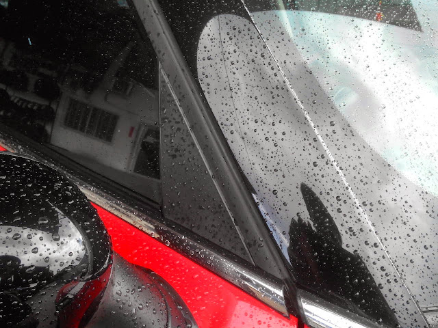

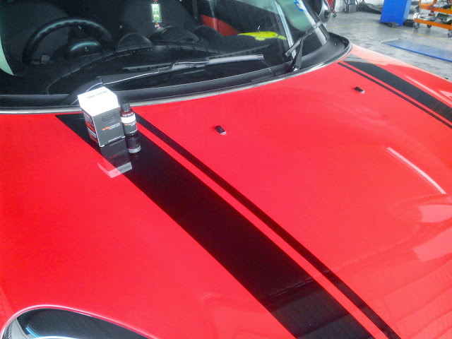

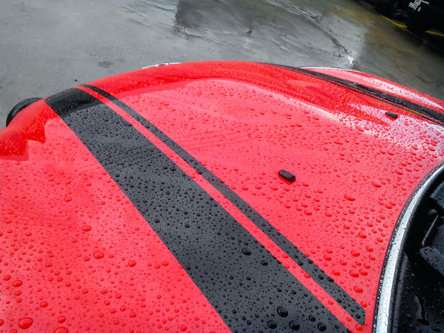

After a 3 step paint correction, the surface was applied with 22ple VX Pro Signature Glass Coat

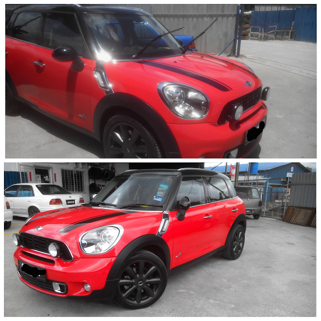

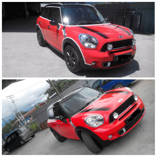

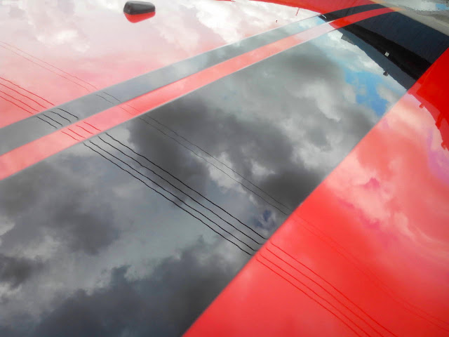

Some before and after pictures of paint correction and coating. Note the slight pink hue of the uncorrected paint. Bright red colour and gloss were restored as well as added durability and paint protection.
Here are some after pictures of a 35 hours paint correction over 4 days, followed by a coating of 22ple VX Pro Signature Glass Coat
