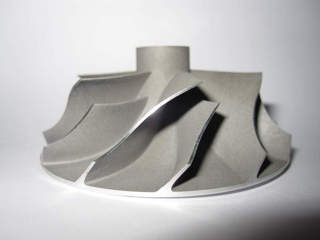

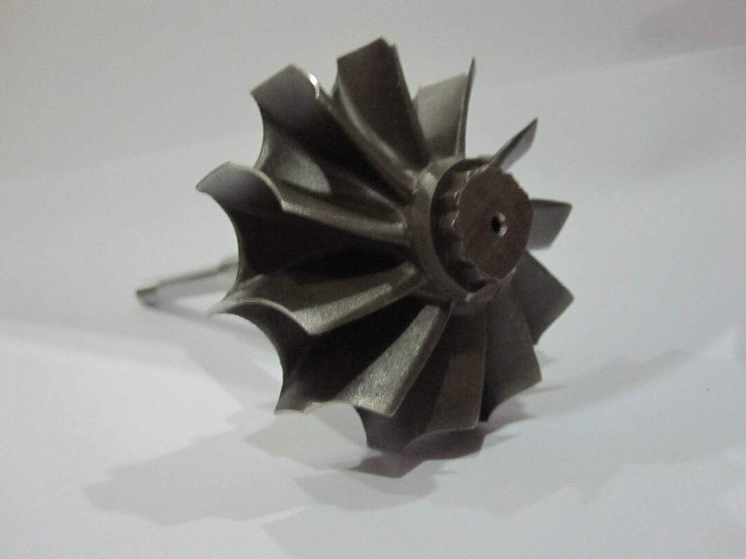

i plan to offer turbocharger upgrade for evo 4-10 (stock turbo upgrade). But i do want know wat evo's owner think about it.
my Upgrade option is:
1. Bigger compressor wheel td06-20g wheel (400 below)
2. Complete Turbine and compressor tdo6sl2-20g (400+)
price- donno yet but i consider it cheap
benifit- plug n play. No modification need
result- on data yes. Actual..no. Want to be my 1st customer give a call.. Haha

No bro i didnt have any Ti,or Mg Fin ...i suggest u find TME turbo's then u'll get wat u r looking for..
i only hv Al compressor fin with nice Inconel tURBINE WHEEL:nurse:
pm for the price.

Bro.. Normal is by only Change the comp wheel to 20G wheel but the Maximum Upgrade i change the Turbine wheel that mean it totally td06 turbo no longer use the tdo5 wheel and comp wheel.
for staying below 400hp normal upgrade should be enough but if u r looking higher u need it Max!
the different between both upgrade is the spec of the turbo are different.
the price also diff.
this upgrade is a solution for those u want to maintain the originality of the engine bay :proud:or sleeper Killer..:hmmmm:
