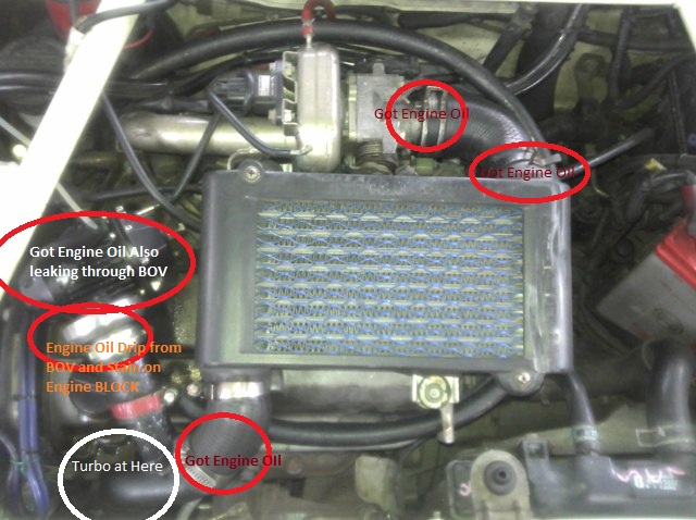

Now I want to Clarify My Issue more with the process + include some picture jpg.
I own a 2nd hand L5(EF-RL) 3 cylinder turbo & Reconnected the EGR.
Originally the EGR hose left hanging in the engine bay, its running due to contain engine oil in the hose and my air-conditioner sometime got engine oil smell.
Mileage Clocked now is 48k++.
last change new engine oil at 40k mileage with diesel engine(Petronas Urania rated 15w40) oil pure synthetic. Now change engine oil ady to Penzoil gold 15w40.
EGR connection process trial and error discoveries:
1st try- removed the intercooler (no Engine Oil discoveries nearby the intercooler connected hose) to access EGR and connected to the Butterfly valve
2nd try - Due to high RPM(electronic tuned) & Discovered i used rubber hose wrong due to engine block heat, Which leaked at EGR head n i change to radial type hose. Removed the intercooler (discovered Engine Oil nearby the intercooler connected hose - refer engine bay jpg).
My Questions:
1) Is my EGR End connected point correct? - refer to EGR Connected Point at Butterfly valve jpg
2) I want to double confirm is my turbo leak/spoiled due to discovered oil at the connection point? - refer Turbo View 1 & 2 jpg.

bro....L5 is mira engine rite? recommended oil grade should be xW30....and i dun think diesel got such grade. and why diesel engine oil?
hv u check if ur EGR is functioning or its jammed? it tends to jammed as carbon build up inside if it has been left hangover there for long time since u mention its not connected before....
if engine consume more engine oil...either from turbo or engine itself only...u gotta check it
ur blue smoke is caused by engine oil leaking from somehwere to combustion chamber....
