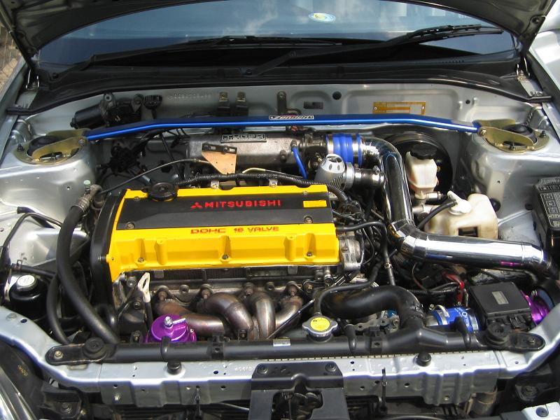

im just finish do some transplan to my car n will up load pic tmrrw. if posibble by 2 nite!!!!!!!!!!!!
now hyundai oso can play wit wira n evo ma.......

spec of my car
engine still standrd tiptronic 4 wd
mount engine All 4 of it relocate
dashbord fit in but need mod
crossmember use hyundai
diskbrake hyundai(will change tis week)
rim work eq03
tyre yokohama prada spec 2(4 pis)
FUTURE MOD
stainless piping
blow off
front mount intercooler
long live hyundai!!!!!!!!!!long live hyundai
Bump: more picture
Bump: hope can see more hyundai mod in malaysia n become more reliable car to run. i think tis is 1st car(hyundai accent) tat doing some within klang valley. wat i see elentra/ sonata/hyundai2001 hav do some mod but dis model not yet i think so.correct me if im mistaken. anyway chow..... see u soon wit some mod thankzzzzzzzz................any suggestion/ idea pls reply for future good.

nicely done man... bravo but i have some questions here:
1. where is the intercooler mount to now?
2. did you dyno the car yet?

i/cooler post at pssnger side dyno not yet coz nxt week need to do piping for frnt mount i/cooler any qstion can sms to tis no 0193658515

since i'm also driving the same model, but i think you are the first one who mod the accent to this kind of monster power... nice done man... would you mind to share with me how is the engine mounting and the cost of doing this? reliable? cause last time i asked the prive of putting evo4 engine is 13k++ :rofl: sigh~~~~~~

wow..4G93T Lancer CK..Nice job done..lil pocket rocket

nice job man!!!:itsme:....never see this before...last time i saw elantra with 4G63T Evo 6 inside...i never know accent can converted like this!!:love:.....a new monster was born..hahaha..congratulation....how the performance??..

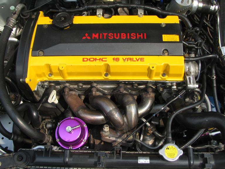

SORRY ALL FELLOWS COZ LATE REPLY. JUST WAN 2 UPDATE. MY LATEST RIDE SPEC N HP
SPEC:
TDO5HR(E7) 16G
WASTEGATE 38MM
BANANA CUSTOM
BOOST 1.0B
EMANAGE BLUE
FRONT MOUNT I/COOLER
DYNO HP 200WHP UNDER SUNWAY(BRO jo)
WILL UPDATE NEW PIC 4 U ALL
N HAVE A NICE VIEW.
