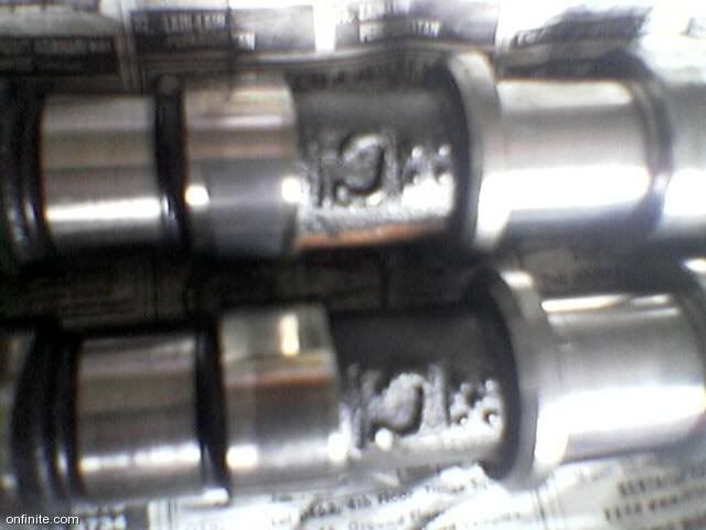

an extra tip for u: when doing head maintenance, NEVER EVER use valves from spare part shop (those with MADE IN JAPAN stamped on it). if ur OEM valves bent, go find used OEM valves. they are tons better than new non OEM valves.
this is what happened to mine.
broke my piston as well... lucky no damage to the cylinder wall...
woo..what happen to the valve actually?
is it melting bro?
some said we can used any of 4G6# family valve, ex: 4g67 NA, is it ok?
all size and colour is same,marking is same, but i dunno its material made of.

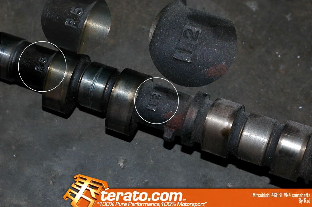

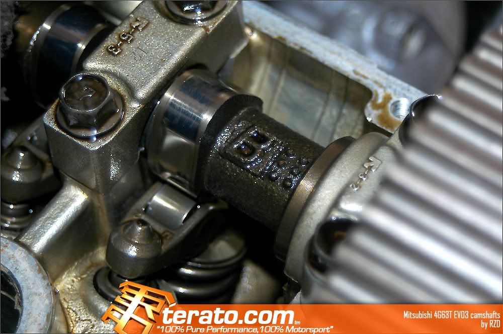

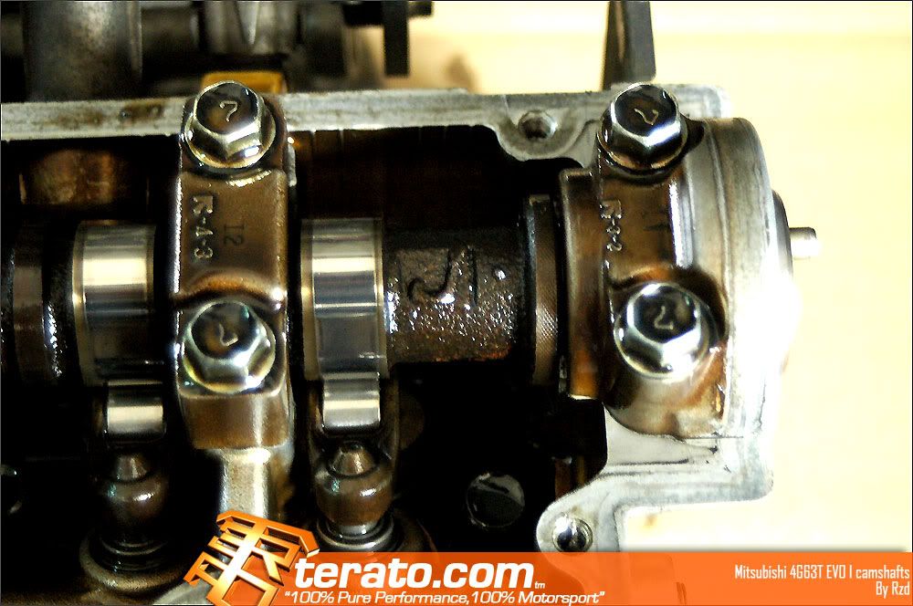

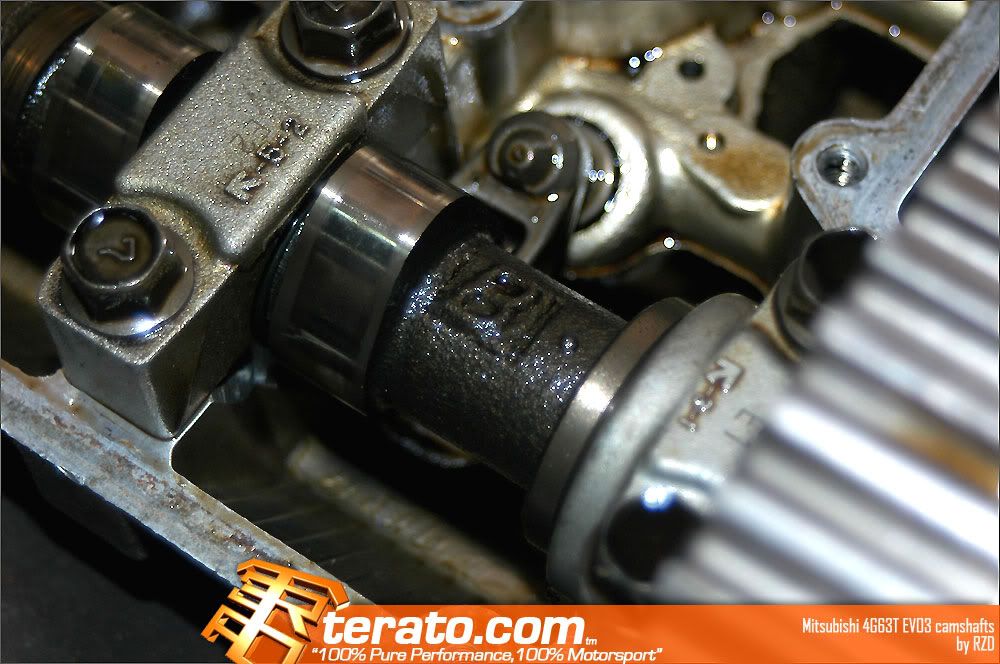

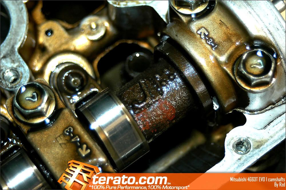

Got from others forum..
Vr4 camshaft
Evo1
Evo2
Evo3

another tip:
the ends of the cams (there are 2 ends - campulley side n cam angle sensor side).
there will be markings for evo cams on the cam angle sensor end. for vr4 cams, no markings.
owhh got it...thanks bro khoyos...
some pomen said, evo 3 cams cannot be reconize by the markings B with dot,
i dont know how far the truth. huhu
