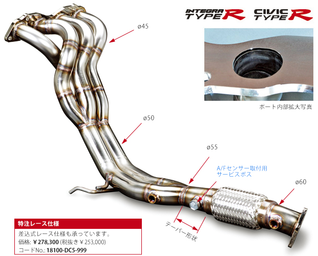

Hey guys, just wanna get some advice on headers/extractors from you guys.
I'm looking at getting headers for the DC5... but i'm torn between budget (circa RM1500 - RM2000) and choice...
What I really want out of the headers is mid end torque, where the DC5 is definitely lacking. I've header theories that to gain more mid end... you want the "2" portion of the header to be longer in length.
I've done reading up on ClubRSX.com and also searches all over the Aussie forums too, and most of them recommend TODA headers for street/bolt on use.
But i've also come across the guys in the states talking about SSR Headers making the most power.
I'm interested to know what the Malaysian guys think about these brands.
Spoke to the guys at Jaafar as well....and they mentioned they have a cheaper alternative - SuperCircuit, which from me searching all over the internet... looks like a Malaysian brand (like Hotbits). Anyone have more info on this? RM1,600 for a raceheader is pretty cheap... but is it also "cheaply" built.
My gut tells me to go with TODA... but its hard to find one for RM1,500... which is my budget.
Any advice?
*Slurp* TODA Headers

Does anyone know what size the TODA Collector is?
EDIT: Ok nvm...found the info on the TODA website... Their raceheaders are sized:
Ø45mm → Ø50mm → Ø55mm → テーパー → Ø60mm

So if you compare the SuperCircuit with the TODA... The TODA has a longer "2" portion while the SuperCircuit has longer Primaries "4" and also collector "1" portion.
Can someone roughly explain what the difference in length for each portion will do?
Supercircuit and Kidd Racing look almost similar...
Urm... I was taking a long hard look...and the Kidd Racing secondary "2" portion is stacked up & down on top of each other.
Supercircuit is stacked left and right side by side each other.
Not sure how much difference this makes... However, based on some readings:
Shorter, large diameter collectors have more peak power.
Longer , smaller diameter collectors have more power in the midrange.
So technically, the Supercircuit headers should make more midrange power than the Toda headers due to the collector "1" portion being longer...
