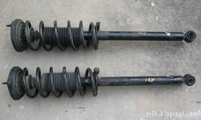

this mine rear absorber..

Looking at the pic posted...yours are the fork one...should be the GTT setup , as also having the HICAS on it.
You can go for the GGT front set as well...
