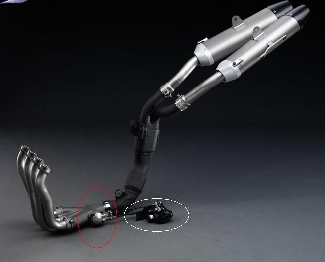

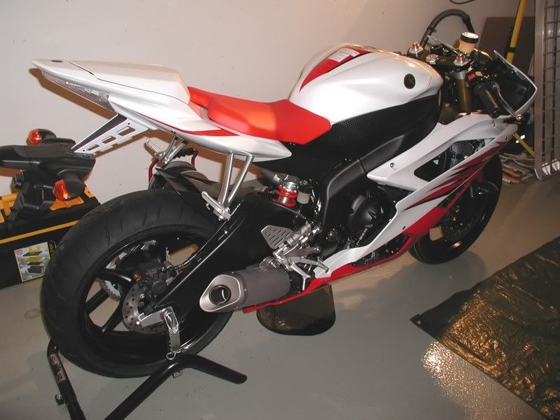

heres a picture of my fwens bike with exup,it has short pipe but valve is there to mimic long pipe preasure,well this is not exactly his bike picture but same model,so basicly u get the idea,and ill post my bikes exaust system.

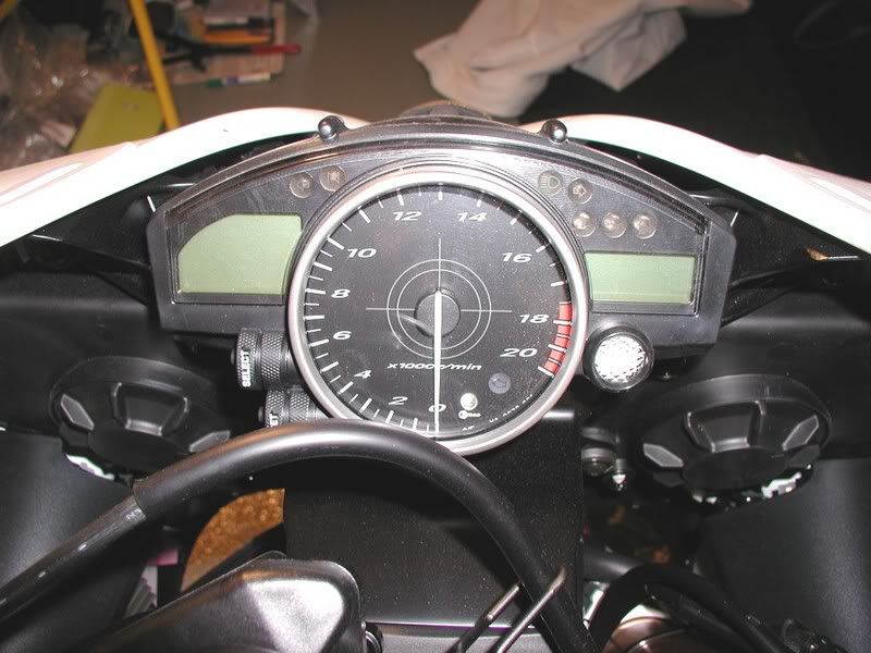

well this is the rev,20k its tuned for high rpm running
well this is the short exaust if u can notice,theres a valve in the mid pipe to mimic longer exaust as i said
and this is the valve,the white circle is the motor to control the valve or named servo motor and the red circle is the valve actuator,and the way it move if im not mistaken is depending on the throttle,it will go adjacent wit the throttle twist im im not mistaken,this thing toooooo many electronic,even meter dun have cable,digital al the way,and if u put a transistor at the servo motor to make it open all the time to save money rather than buying rm12k fullsystem the meter will come out error code and ur meter will go crazy,so basicly do it properly or ur car will run like $hit
