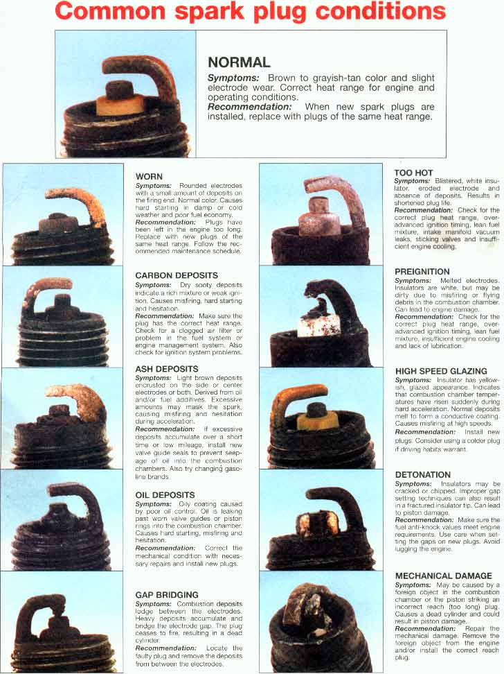

Forgot to add, found this at this site
Normal, but with red coating: The red coating is a result of the additives in lower-quality unleaded fuel and will be visible on the plug's ceramic insulation. The red coating is not an indication of any engine problems.

Thx bro papagoines for your kind info and the chart. Well at first it was more to overheating but just now when check the plugs again, it seems to be back to normal again ....... I guess i'm running too lean of a a/f mixture.
---------- Post added at 09:23 AM ---------- 6 hour anti-bump limit - Previous post was at 09:19 AM ----------
Thx bro papagoines again for your useful source. Really appreciate it !!!
After reading it, its seems like the might be problem to the fuel too ......
