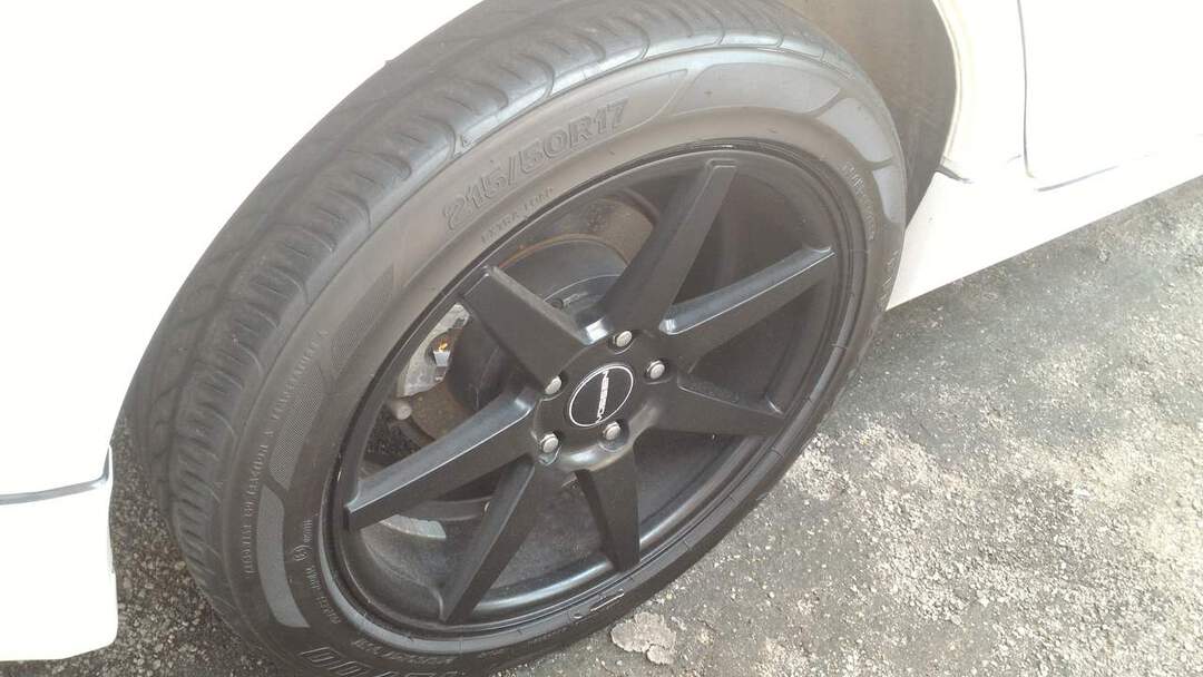

1
Hai.. i have install my inspira using eibach pro kit spring.. my back tyre low down 3 finger fit.. but the problem is my front can fit 4 finger..anyone can suggest the best way to me how to fix this thing.. i use stndard damper.. tq
Change only the springs nothing you can do. Better off getting adjustable....:smokin:
