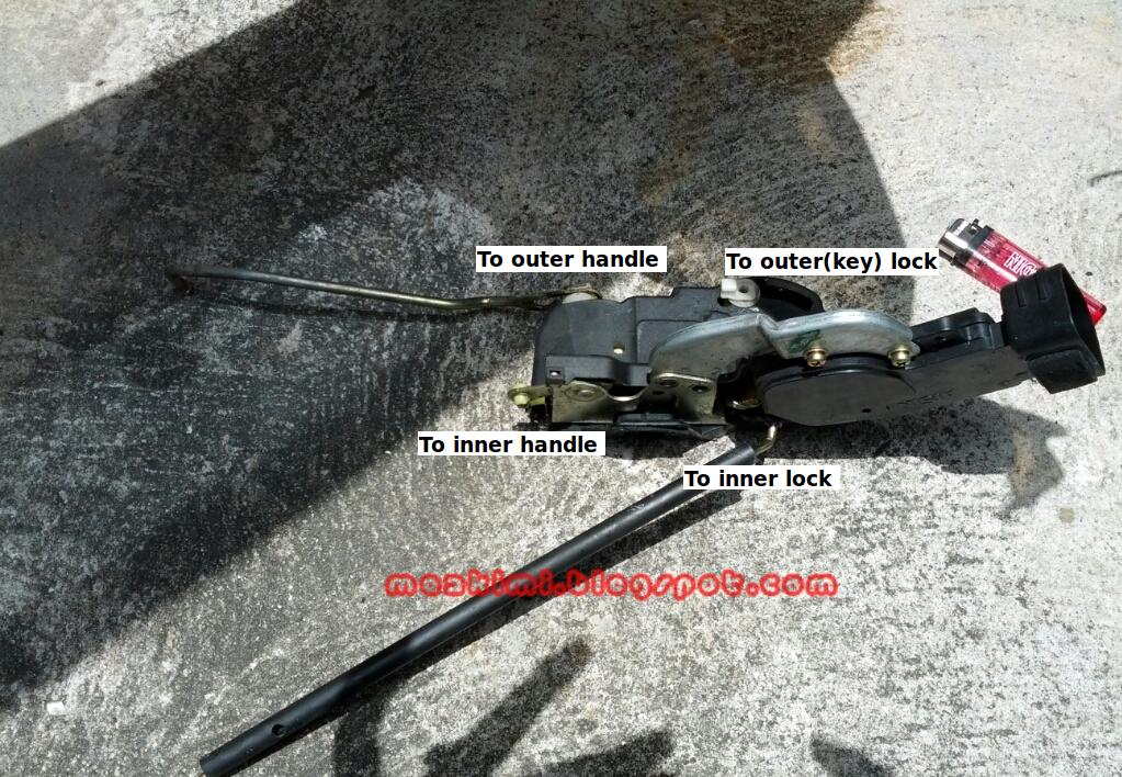

Here is the picture of the door lock assy with all links labeled.

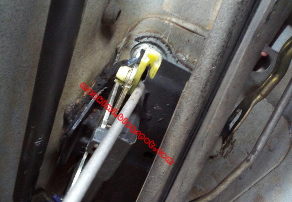

Remove clip that hold link for outer handle and remove the link

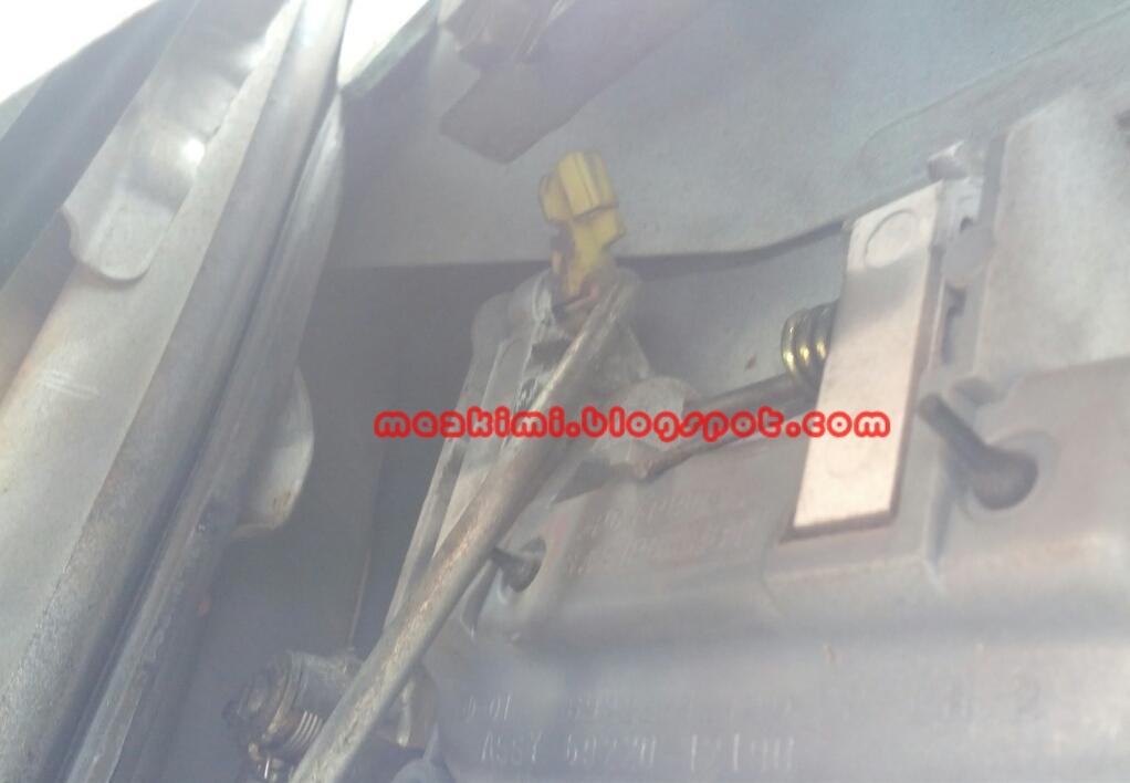

Release clip that hold link for inner handle and remove the link.
Release clip that hold outer key lock and release the link.
