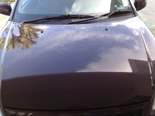

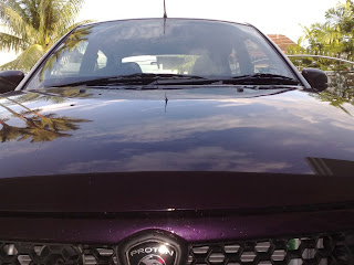

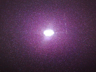

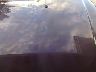

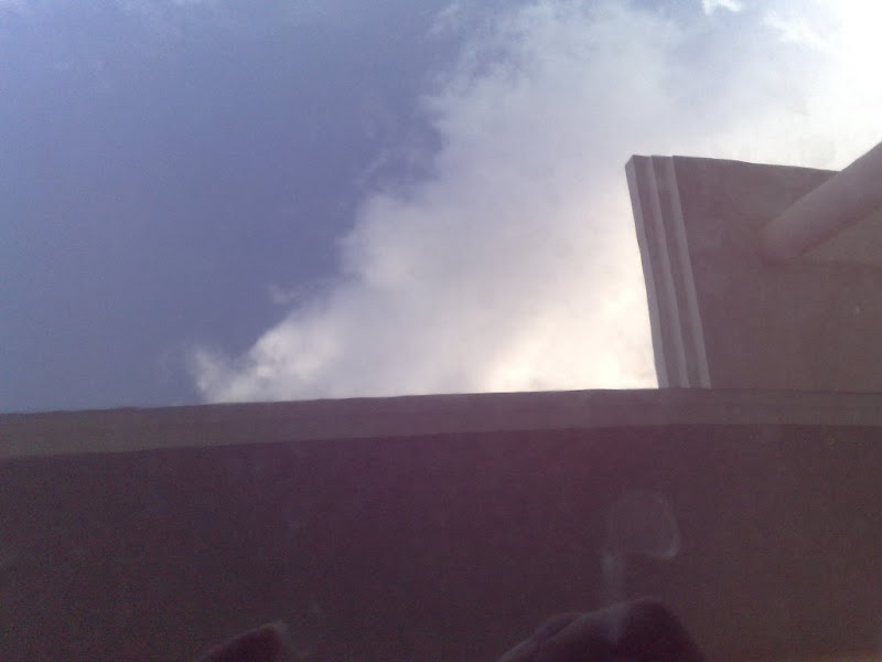

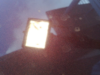

this is the reflection before detailing

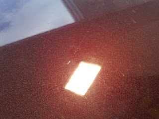

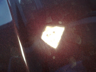

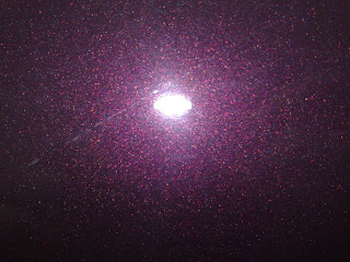

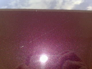

the most visible scratch on the bonnet
a four month old new car, the paint fade due to acidic air from industrial area where the owner works at

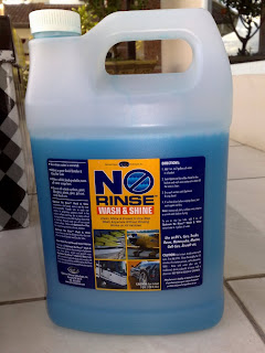

this is the alien juice that does the 1st magic step

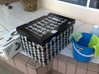

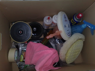

my "tool box"
my messy tools

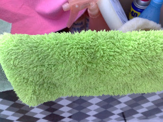

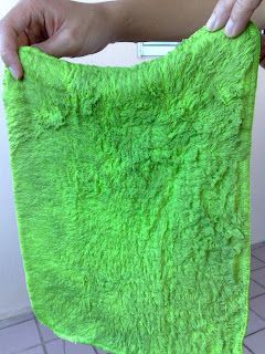

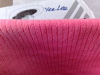

the micro fiber cloth i use for cleaning
the MF clothe i use for cleaning the wax
the MF clothe i use for drying the water
since it;s only a test on half of the bonnet, very little ONR mix wif maybe 1/4 bucket of water

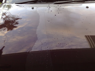

b4 ONR treatment
after ONR treatment, the water now spread on different path
after a few second from the previous pic

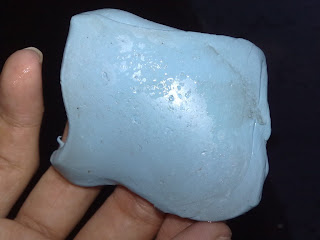

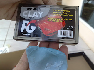

step 2, clay
using ONR as lubricant
minor contaminant picked from 50% of the bonnet

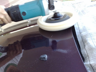

rotary, meg's M105 wif wool pad for compound

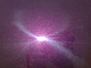

after 1 pass of compounding, the hologram that cause by the remaining of M105
after compound using lake country cutting pad wif M105
polished with meg;s m205 with the combination of lake country polishing pad

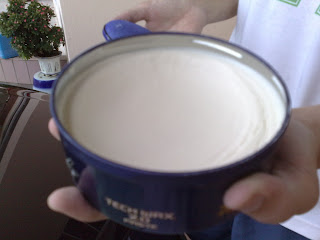

time to seal today's hardwork
the flakes appear

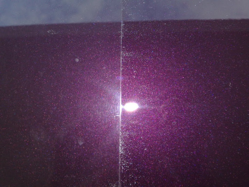

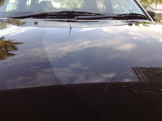

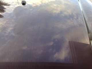

owner's request, i did a 50/50

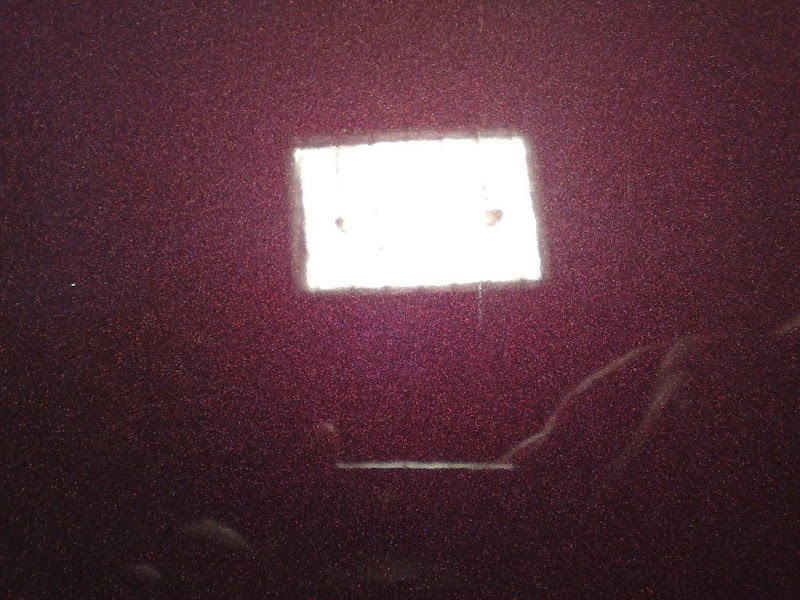

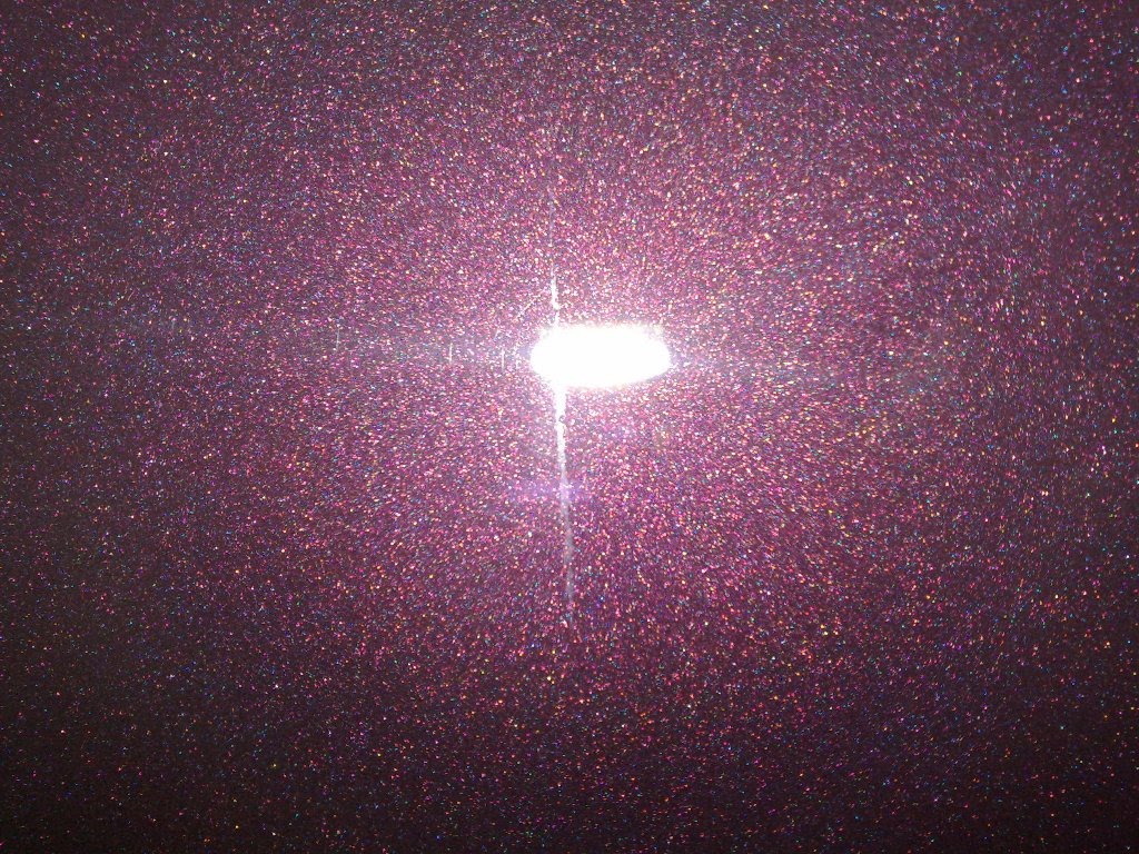

using flash that differentiate b4 n after detailing

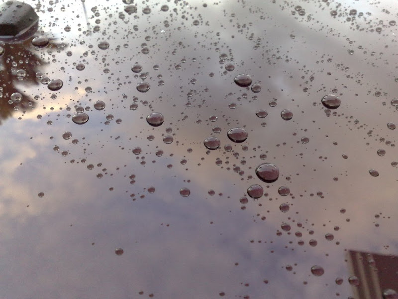

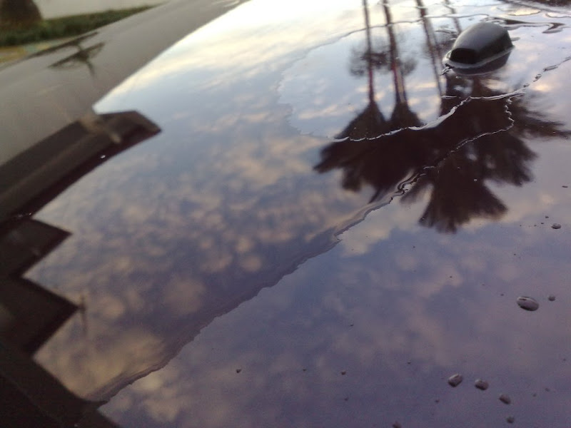

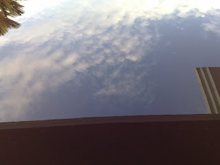

let's pour some water for test

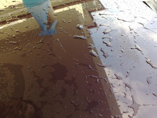

water beading
water that sticks

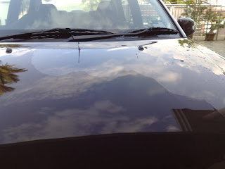

scratch from the begining pic is gone
comparison of paint flakes
total spending time, 2hour from 5pm to 7pm
most of the time explaining things to the owner
hope he likes driving a half detailed bonnet around

Hey , mind sharing your sponge thing .. I have the machine , the adapter .. but I can't find the sponge .. I have tried using polishing sponge from B&D for rotators but they are too big for my adapter
great to know that u have a ROB...there aare Lake country pads avail .....cutting, polishing & finishing...you have to be evry careful in chossing your choice of foam ..as it is always...as the side lining between the velco & pad seems to get detached & cracked
water beading
water that sticks

mind to tell me how much and where u buy ur clay and those polish wax?
i want to try do it.
