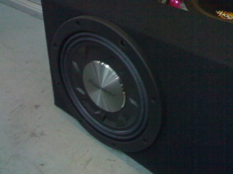

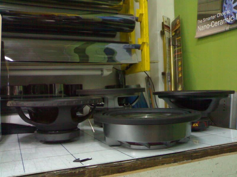

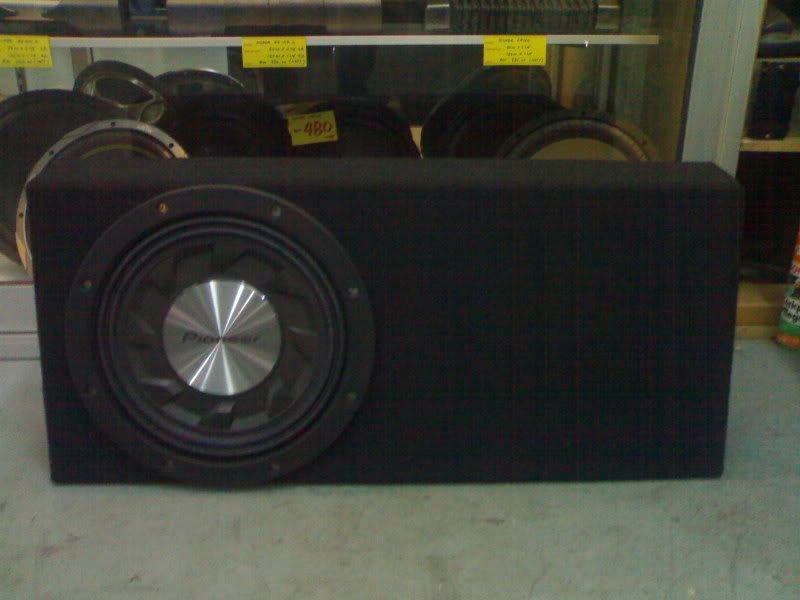

you might wan to look at these if you wan to save space...
sub box can make them long and thin... around 0.8cuft for sealed box...
