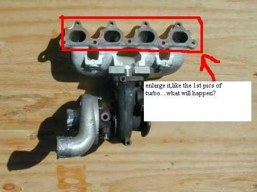

as u seen on pic above(with red circle and right sign),what benefits to our cars??
can make it spool earlier or any goods?

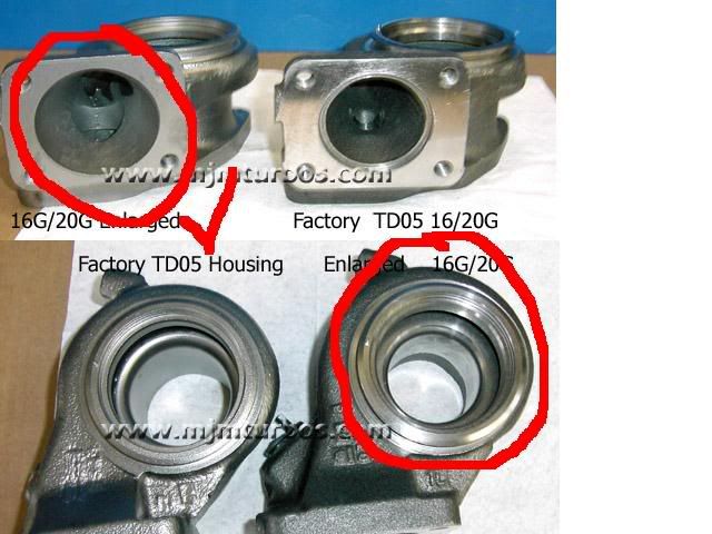

the 2nd pics(only the red circle),if i bore it like this??std fin can fit back again ka??

never seen that mod b4..but it looks like it gives better flow..might give u a lil better response.
adibk10 , u can do normal porting
extremes one like tht in malaysia dunt tink so they do em
even tong doesnt want to do
yes,tell me bout this?why so dangerous...but from what i learnt at University b4,its more like the nozzle of rocket...diverging and coverging
its a back housing rebore,this mod can be done but must see what compressor housing u use and what fins are be used..stock fins may a bit laggy
why lag???
is't the boost come's out late,and the G's output will be greater than the stock?
sound interesting...
tell me more bout this?
after get more feedback,tomorrow will be the project of me to do this..
if u do this thing , u will get more output at higher rpm , will sacrifice the low end
flushafteruse said:
for this turbo spec also must depands your engine spec...what engine u use,mods
yes better see what engine u use for what purpose?:shades_smile:
im using nissan march superturbo engine..which is 0-4000rpm runs with supercharger and 4000-7500rpm runs on turbo..just wanna feels more G's on 5000rpm and above..does it make any sense by doing this porting(on pics no 1)
porting turbo housing n back housing i think doesnt make any much diff,unless u bore comp housing n fit in larger fan...its just my 1cent
ok..i'll start my project by this afternoon..thanks..will let u know the result soon
this project give me a short time only..just using drill.sand paper.autosol..i think u'll better remove ur tulang ikan or boost controller before installed back the turbine..coz my boost spike la..one more turbine very responsive..
