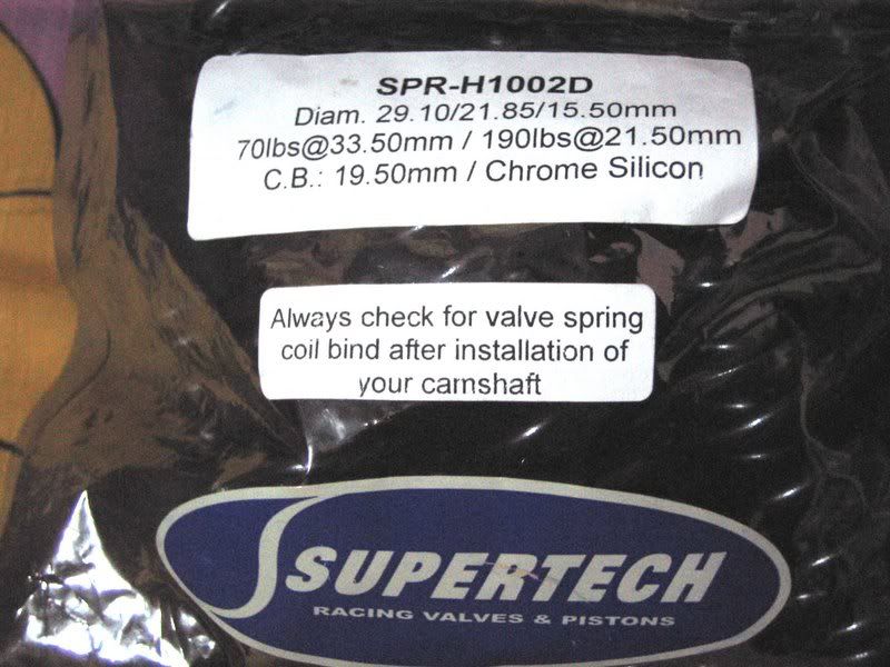

Has any1 tried skunk2 tuner cam stage 1? I'm planning to get them. Planning to use d cam with tuner valvespring n stock retainer. But a fren offer me supertech valvespring. Aren't d supertech too stiff? Feedbacks any1 or comment?

I know d supertech wud fit. But isn't it too stiff. Seat pressure is 70 pounds. Won't this cos wear quickly. Skunk2 Tuner is at 50 pounds. Furthermore if using supertech vs n using stock retainer. Wont my retainer break easily due to stiff vs. Comments any1? Let me know. As i can save budget

i mean the supertech vs. any1 tried them b4? a lot of pple in uSA using supertech, but they use in high applications. If light cams for everyday using supertech vs with stock retainer. can it be use everyday?

even no over rev. but the super tech vs seems hard oh..

I guess you didn't get your answer. Anyway, i'm using the , old model last time and pressure was about 70lbs. Basically it can clear using s2s2 to SK2Pro2. Although i haven't been using the cams yet, the titanium retainer is holding up pretty well with rev around 8200rpm and its my daily last time. Basically, when choosing the springs, be practical on the RPM and the camshaft selection. Select whats in the range of the cam lift. With stiffer spring, its kinda hard on the timing belt so you might want to opt for a stronger belt or non-china made timing belt.
Hope that helps you. Ps. skunk2 stage 1, just use the OEM type R, its enough to clear.
Oh yeah, valve spring don't eat the cam. The stiff valve spring wears out the retainer, if the springs are TOO stiff and revving crazily. Remember, race engines are rebuilt frequently, so think about it. That goes for every part of the engine, not only the retainer.

Ti retainers more durable than stock retainers? That is a wrong impression there. The trick to it is to match your spring pressure with your cam requirements. Don't go overboard with it if your cams don't require those spring pressure.

why don't you use aftermarket steel retainers then. Just for a peace of mind.
If you read through the web, people use hard core springs being afraid of p2v hitting due to valve float. So choosing hard springs is theoretically the right move, but thinking about the spring pressure with the cam lift sometimes is ignored which is what you are doing at the moment.
SFL's point is clear enough to answer your question and i have to agree with him. S2S1 is not far off from the CTR's. I wouldn't use anything any aftermarket valve springs with stock retainers apart from the Type R the most. Even if you read in most threads on the internet, some are using the Ti retainers longer than me and even after taking out the valve train for inspection, its still ok. But they rev decently, not 9000rpm shifts or 10000rpm shifts every time.
