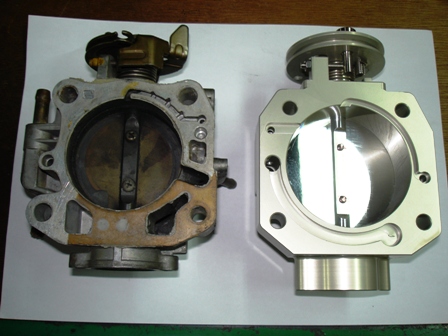

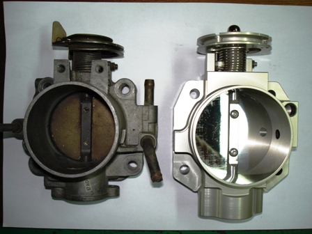

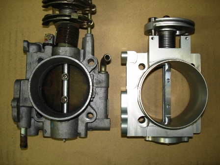

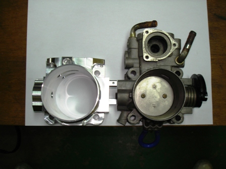

Oversize Throttle Body ! Is it the faster way to put out your engine potential ???

Bigger TB is same as carburetor engines putting on weber. Larger intake, shorter air travel and more direct respond, will resulting about 5-10horse power increaments (may be vary, donot flame me).
But significantly, your engine respond from low rev to high rev will be improved, you will be able to feel it. But if increase alot in size, remember to readjust the AFR, you donot want to run too lean n overheat/kill your engine :thefinger:

The idea behind upgrading your throttle body is to help provide more air to your motor. Just because you increase the size of your throttle body opening doesn't mean that it will increase the size of the inlet port on your intake manifold. If your throttle body opening is larger than the inlet port on your intake manifold it will create a step. Air will always take the path of least resistance during travel so as it travels along the wall of your throttle body opening it will actually bounce back when it hits the inlet port on your manifold if there is a lip. The bigger the offset between the throttle body opening and inlet port on the intake manifold the more air gets pushed back. There are ways to overcome the problems caused by overlarge throttle body bores but you should only have to deal with them if its necessary to buy an oversized throttle body for your vehicle.
larger is better... but too big is not necessary beneficial...
back to basics... flow efficiency....

Like jinkl mention, it is important to match your TB's diameter to the plenum/collector's inlet.
Remember not to increase it too much, eg : 50mm diameter, increase to 60mm, is 40% increase in surface area. If all other components are stock then you will need to upgrade a lot of other things to compensate for the increase air intake.
