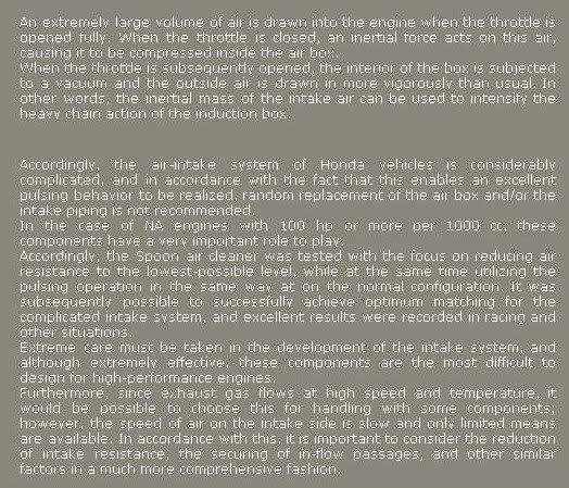

Drop in pod filter for the win. Yes you dont get that vtec bark compared to an open pod but VTEC motors are very sensitive to heat! WHen i ran 400m in champion dragway in April this year, i ran consistent 14.8 - 14.9 all day with the close box and when i ran open box, i manage to only nail consistent 15.0 - 15.2. The heat does effect your performance. Drop in for the win... If you ever feel the urge of wanting the vtec sound, you can always open the top part of the box to get that mad VTAX sound!
quote from sipoon
im using the arc chamber with stock airbox,will order the in box filter from spoon soon
i felt diffrence in response when i use the arc intake chamber with stock airbox compare to stock rubber hose without filter
last time tried hks,apexi and cap ayam.felt apexi the best.
now want to try stock airbox with spoon filter:biggrin:
Let me know of the experience. I sort of think the spoon filter is too much in terms of the asking price.
So far, friends that I know of never had good experience with the fat tube, but seems like a lot of people like them.
