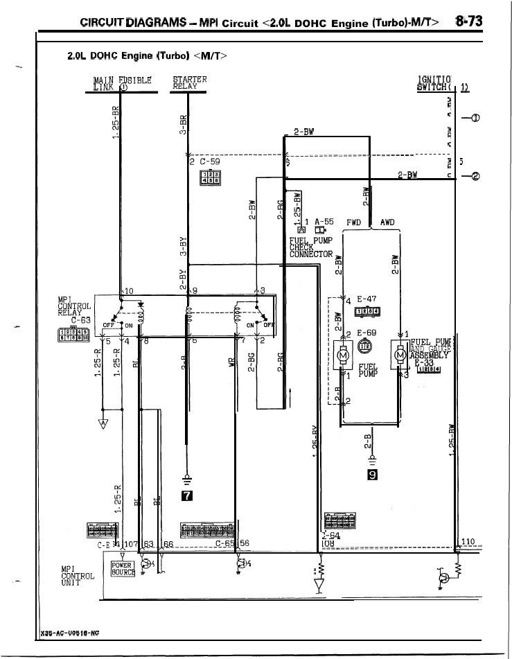

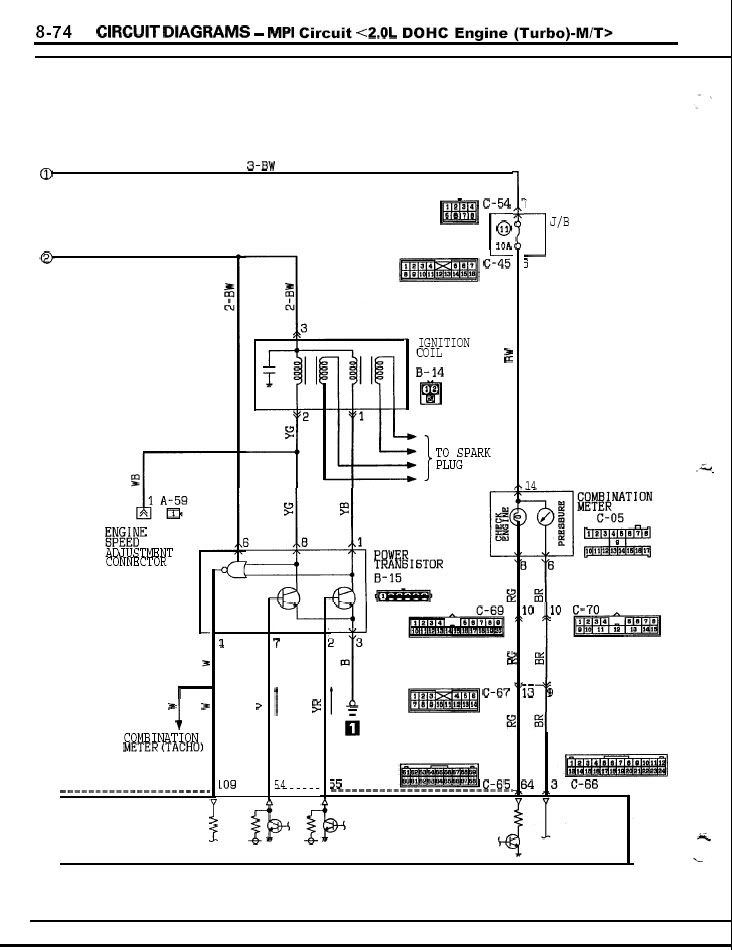

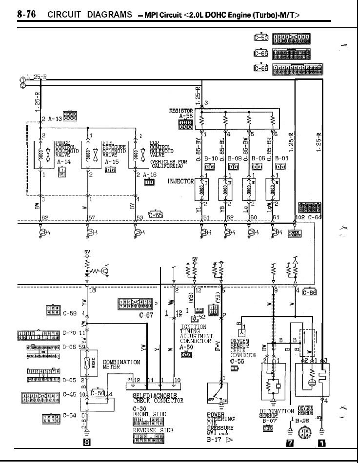

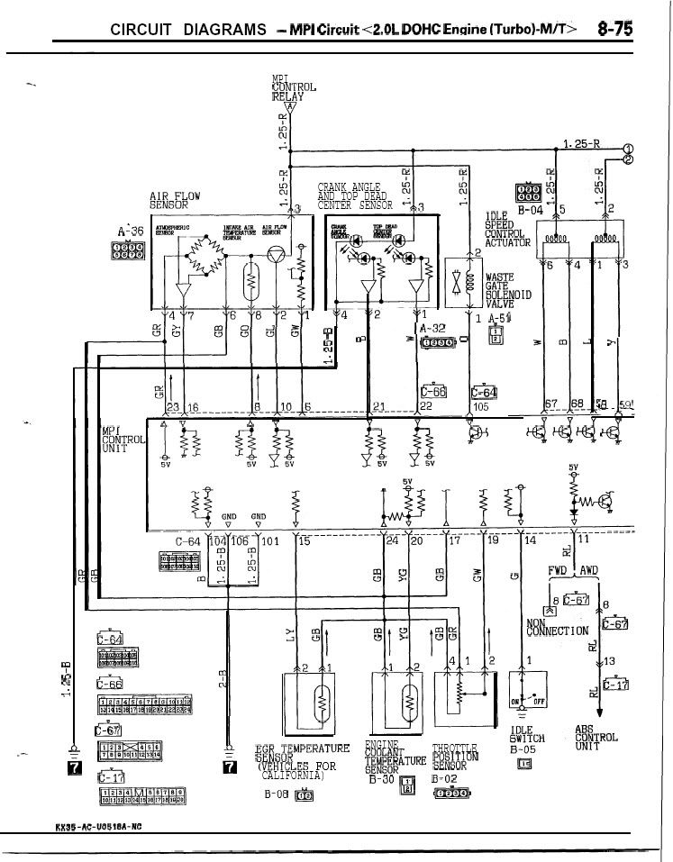

try a torrent site or archive for a full car blueprints. not too sure about if they have the VR-G galant ones, but for most perfomance cars, it is available. last option, pay-site :D

Thank you for your help. But the monitor that i've got was wired with the Galant Legnum V6 2.5L engine with triptronic transmission. I afraid that the diagram above can't be use to wire this monitor. Now the speed meter, RPM, and water temp is working but the fuel level and the light that show the gear position doesn't work yet. I hope to find the wiring diagram soon to make it all work. Thanks again for the help.
