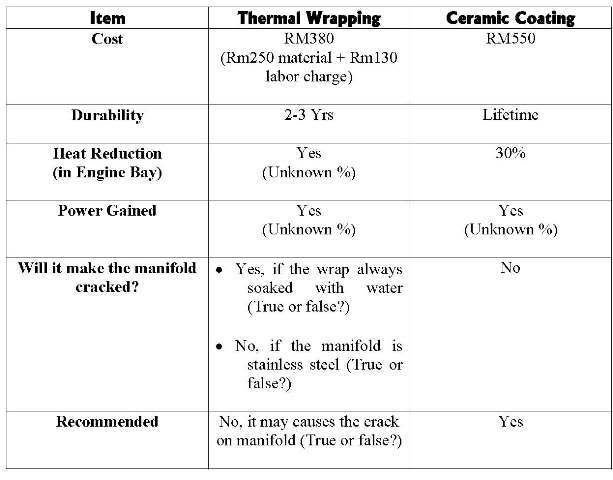

Ceramic Coating Vs Thermal Wrapping to Manifold / Extractor
Pls comment the following

Bro sincere1... could you post the contact for the ceramic coating for rm 250 below.... cos last time i called a company posted in motortrader.... they ask for RM850 for a ceramic coating... huhuhu my 4-1 header cost RM650... ceramic 850 LOL..... not worth it.
I prefer ceramic coating..... anything as long as it wont cause rust... cause once rust develop... it will cause the system to leak exhaust fumes...

Ceramic coat to keep the moisture out. Coating does remove alot of heat from transferring out to the air so it is beneficial on both counts. Once you have ceramic coated the piece, then heat wrap it. I used a spiral pattern that overlaps halfway all the way down so it had 2 layers of wrap. It reduces temperatures in the engine bay ALOT. Not to mention that if you have an aftermarket turbo manifold and do this to it, it will decrease spool time a little bit by keeping the exhaust energy on the inside if the pipes so it can turn the turbine.
With the wrap on, the ceramic shouldn't flake.
Most of the coatings are pretty thin. They need to be applied thick to be an effective insulator. Heat wrap will trump those 'pretty visual' coatings that many header companies are using.
Flaking, as already noted, is caused by not using the correct coating for the temperature range. And, prep is also very important. You should question whoever does your coating to see how they prep the component prior to coating.
If you want to coat, get the header/pipes/whatever coated inside and out if possible. The inside coating will prevent the header materials and welds from overheating, and will provide that 2nd level of insulation if you want to reduce underhood heat.
Ask your coating company on the difference between cosmetic coatings(the most popular) and functional coatings(which will actually insulate). And, compare that info to the dozen or so other coating companies.
one thing that seems to be missing (unless i missed reading it), is that the coatings are inside and outside on the piping. header wrap is just on the outside. so essentially you've wrapped the tubing into it's own oven. this is one of the reasons a set of wrapped headers will fail faster. you've elevated the overall temp the headers are retaining and the higher temp now creates a greater delta in the cyclical heating and cooling of the metal.
I used header wrap on my 3" downpipe and now i have holes in it because it rusted so bad.
At the very least, get some high temp. paint and spray the pipe to prevent rust.
taken from rx7 club.com
Yeah..... 250 is dem cheap weh. IIRC, Ceramico wants 3x more than that to ceramic coat an extractor.
actually there are many types of coating.... there is heat proof powder coating.... teflon coating.... halar coating... etc.... but as corollagtouring has said.... another layer of heat shield after the coating would be the best... do understand that even 316L SUS can rust... they would not rust if there is no impurities... however, if there are stuff like sand and other metal chips that stick to the SUS pipes... they would definately rust... its only about the matter of time... therefore... if want long lasting pipes, dont really need SUS pipes... use normal "white steel".... coat it with whatever heat proof coating.... then wrap with thermal wrap.... confirm can last very long time....
just my 5cents... (have to round up liao :p)

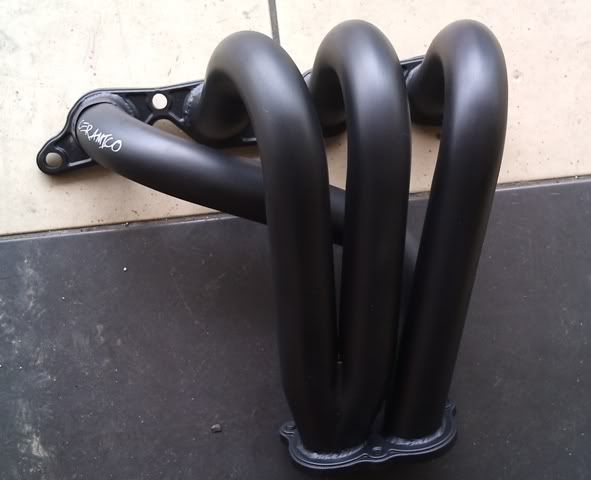

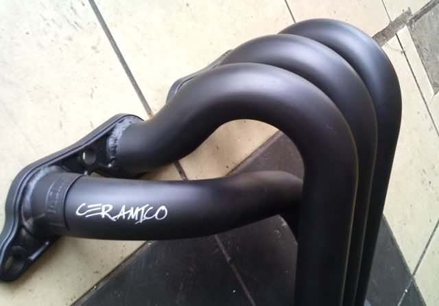

The header had done the ceramic coating
The coating was done on external only, they claimed that no internal coating can be done..
The quoated was RM550
Sorry for my early mistake, i supposively heard wrongly the price
The result is very good, the heat in engine bay is significant reduced compared with previous (non-coating applied). I had forgotten to shot the temp at previous stage in order to compare before and after, therefore no point to get temp after coating had done..
by the way , i am happy with this ceramic coating

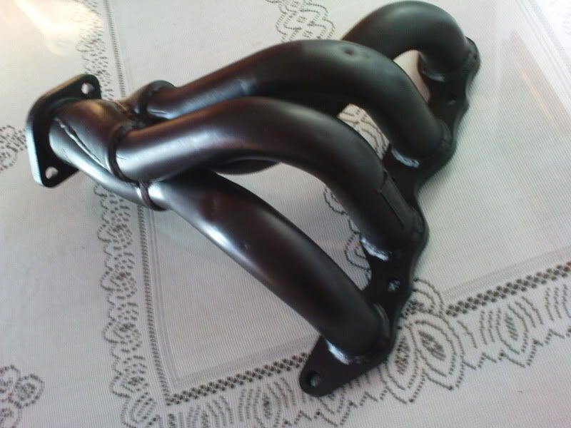

my version of coating... i dunno whether it will stand the heat abuse, it costs RM40, using manifold hi temp paint.... will report the result.
at this moment my customer told me the paint still intact

the hi-temp resistance paint you referred as what i believe the painting same as the purple paint used at Apexi Spiral, the paint will peel off after some times, or i should say after few years..for heat insulation ? let u tell us..
