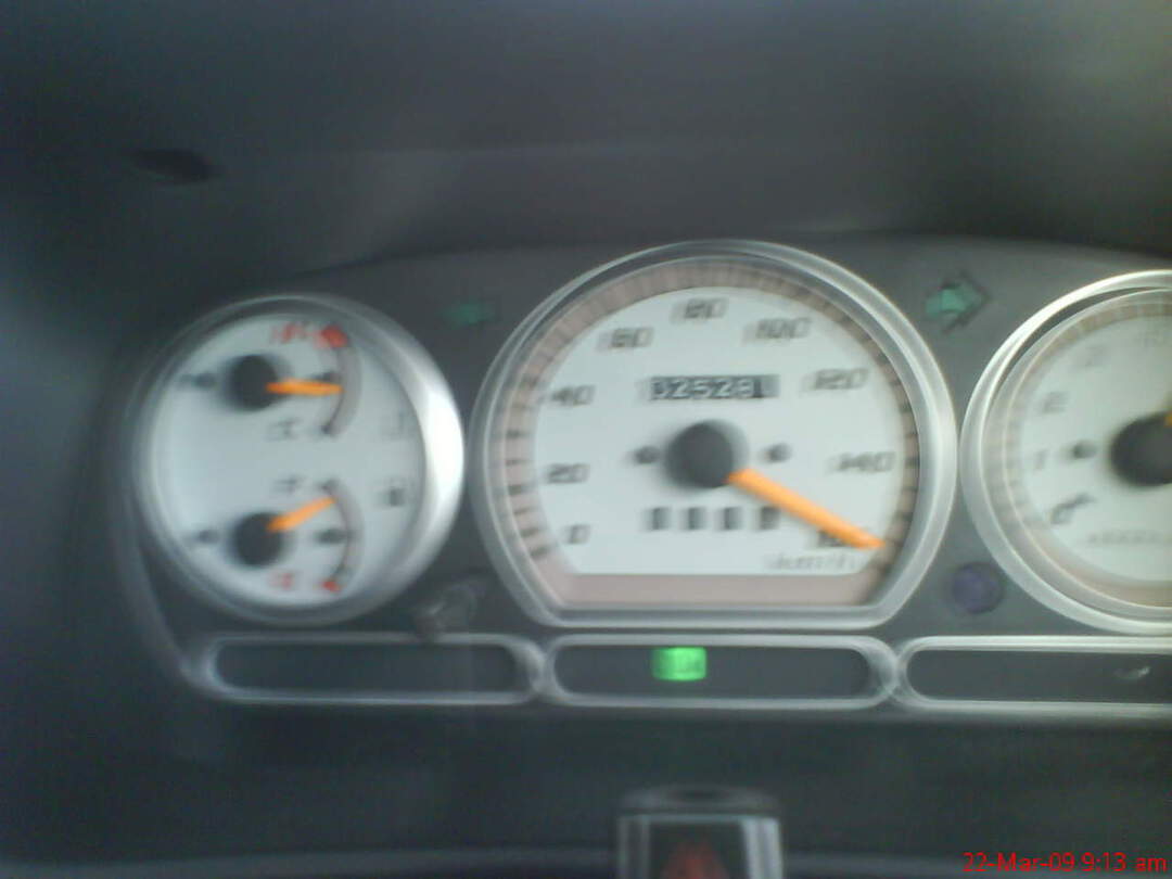

Luke sifu,
How can we make our car reach 160km/j?
A Post Every 5 Mins
My fren buy radiator synergy frm nagamotorsport wit install price rm 1400.bfr cone there my fren car can drive to that shop wit ok condition...aftr pasang my fren car start within 10 minute mati engine.then aftr check their worker not install the water sensor...owner of the shop said can pasang tp radiator coz the heat can give signal to to the ecu....wen i said must pasang back he try tu argue said he more profesional on tis matter....n salahkan car owner that ite rosak i becoz of owner...
