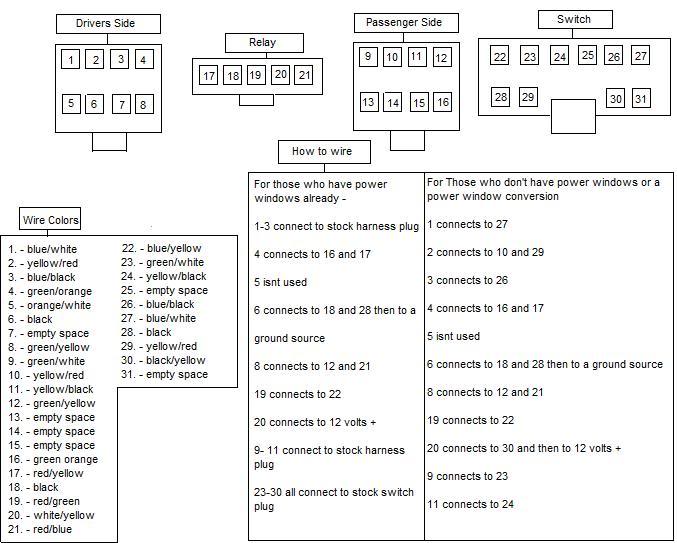

JDM EK9 Auto-foldable side mirror - installation diagram

Bought a pair of EK9 auto-foldable side mirror recently... My pomen got problems fixxing it onto my Ek... Things went ok when I gave him this diagram... Dunno which one he used.. But it helps alot...

good info......
btw, do anyone have wiring diagram for so4 autoflip side mirror for 99spec and above because 99spec switch have built in relay

good info......
Oso heard about dat built-in relay for EK 99... Unfortunately I dun have at the moment bro
