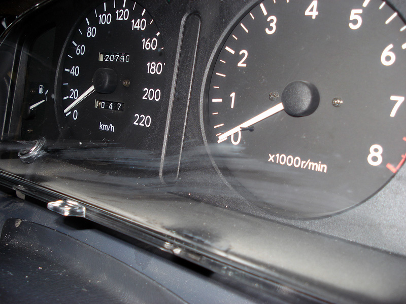

Dear detailing Sifus...
I recently swap my meter panel with another guy. His meter panel cover, the clear plastic got some marks. I though it was stains. But it's not. It's like, the part of the plastic has undergone abrasion. Cannot call it scratch because it's not deep and cannot be felt by touch. It's just like blurred. I heard before people say toothpaste can work, but when I used it, it became more clear wth :stupid:. Please can anyone teach me how to get rid of it? Sandpaper or maybe headlamp restore solutions? Please please please... It looks fugly... It is in the picture below...

hmm u could try Meg's plast X or if its just dirt u can try Optimum's Power Clean

Try to get hold of Meg's PlasX or Autosol Plastic Polish. But be careful with the plastic as it's very soft. Don't polish it with too much pressure as that *could* have been the cause of those scuffs on the first place.

Oh thank you... I try to source it.. It is not dirt...

over do will haze and cause permenant damage to the surface.

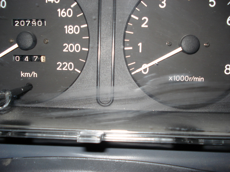

Danz... I've just done it with the 99 soft polish... Quite good eh! Can smoothen out most of it. Didn't damage the plastic. But there are still some parts that couldn't go away. I guess maybe that's on the inner surface :bawling:. But its not very noticeable... The very noticeable ones are gone. I won't say 100%. But it's difficult to see the abrasive marks already. Unless one really stare and check. Can say 85% - 90% gone.
