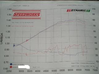

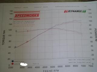

how to understand the dyno picture?
red n blue has wat diffrent?
