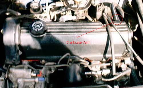

First remove the air box from on top of the throttle body. Connected to the air box will be a short hose (approximately 6 inches long) that connects to the driver's side of the valve cover. This is the air box to the crankcase ventilation hose (what a long name for such a short hose), remove it from both the air box and the valve cover (the crankcase ventilation).
Take the 5/8" radiator hose, stick one end of it in your K&N breather filter and tighten the worm gear clamp on the breather filter tight enough so that the hose can not be pulled out, but not tight enough to deform the circular hose. Place the breather filter anywhere you want under the hood of your car. I initially placed it in front of the battery, later when I made the quad ram air the breather filter had its own ram scoop, but anywhere under the hood will do (I prefer colder air, so a cooler location is best, and one away from moving parts, like the drive accessories, is also nice). Once you have found a suitable location for the breather filter, cut the 5/8" radiator hose to the proper length and connect it to the crankcase vent (as seen in the picture below).

For 4G15 and 4G13 carb engine.... i think this is the hose to install the air breather.
Please refer to the circle witht the red pointer....
happy modifying.... :D

Hi sky_kids,
For 4G13 and 4G15 Carb engine. this is the not the correct hose to DIY your micro compressor! This is because this is not the correct PCV. And i had tried before.
The Correct PCV hose is located at the center of the engine.... normally connected with a long nut. The PCV hose is connected to the throttle body (i think). all you need to do its to add a T-joint between this path and connect with your breather with a control valve.
Hope you guys clear on this... hahaha...
it really make differences..... B)
