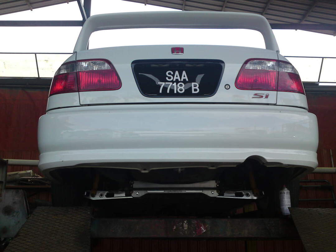

@deathzone
how long u using the ASR already?
and wat lower control arms u using?

deathzone, how does your car feel after installing the lower arm & brace? does it feel more rigid? I'm thinking of getting them also..
mADmAN
Aug 5, 2004
1,840
547
3,213
the brace does nothing on handling... its merely to minimize the chances of ur subframe from tearing.....
i oso just installed the ASR last week in my EG6...along with a set of 2nd hand Blox lower control arms....they definitely look sick....can barely stop looking at them ahahhaha

You guys haven't seem function7's brace yet. That one is even nicer looking. I don't think it is as cheap though. Thanks madman, I was thinking mine was fake, because of that one hole that didn't fit, but from the article, i've confirmed it's original. Bought it from Alaniz, they offered to take it back, but after seeing shipping cost, decided to just mod it.
The handling will be different depending on what arb you put in. Since ori honda has 23mm the largest, I use that. Also have a 22mm, but I like the 23mm more. For eg subframe brace not really required. No one breaks the subframe of the eg with big arb as far as I know. The only problem is locating a u bracket and bush to fit, or for some, mod the ori bracket to accept the bigger u bracket of the dc2, or find a dc2 arb subframe bracket.
mADmAN
Aug 5, 2004
1,840
547
3,213
actually... function7 arms and brace arent that much more expensive...
considering ASR brace is around 8xx in malaysia... F7 is around the same price...
so is F7 arms when compared to ori Skunk2 arms in malaysia..
only thing is... it gets expensive when shipping to malaysia is involved...
best part about F7 is that their bushings are made by Energy Suspension according to their specs... and they have a lifetime warranty on their arms and brace.. even the bushings are included in the warranty...but whether or not the warranty extends all the way to malaysia is a diff story.
