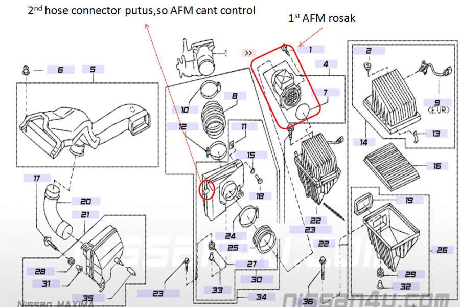

wow, fuel filter so x-pensive. i remember i chg at aprx rm 20 niah.i also encounter engine die off when driving.1st time it was AFM change AFM solve problem. 2nd time was after AFM box hose connector putus so AFM cannot control.
2nd happen time is due to hose/tube is already harden when foreman dismantel hose accidentally break off then he told me this one no problem one. when i start engine can start when press a accelerator engine die off. sometime start also die off. so he replace me 1 set fix in wah lah problem solve.
