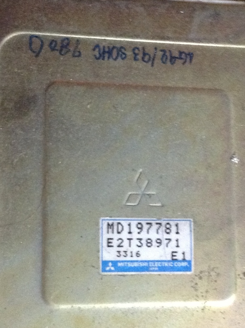

7781 ecu in 4g92p
dking91
Mar 26, 2013
121
11
518
pekan
rechip then plug n play? :)
---------- Post added at 07:23 PM ---------- 6 hour anti-bump limit - Previous post was at 03:13 PM ----------
update..just try plug in the ecu..the engine sound like 3 cylinder...the tuner said cant use coz it come from old libero..need to find air flow sensor and injector of that model... another failure :( wasted my money
E-Tech
Jun 28, 2005
1,115
256
3,183
Johor
Bro... trust me..can be used. Need slight mod. Pm for details.
Tq
Japan ecu only 2 injector transistors to control 4 injectors.
Local model 4 injector transistors to control 4 injectors.
So to make it work...email me.
GEFORCEXTREME
Nov 18, 2009
151
13
Each ecu is custom tailored for each car... What injectors, maf/map sensor, and a whole lot of otger things. When someone say can use, maybe he mean with mod or retuning/reflashing... Not pnp...
k0pi
Jun 19, 2011
105
28
528
Kota Bharu
yep... I'm using it with 210cc injectors on my 92p. Worked well since... 2005.
like E-tech said - needs a little bit adjustment.
it'll sound like 3cy because you're running on 184cc injectors. Even if you have AF management, the base correction will surprise you before tuning to getting AF at 14s - 13.5s evn at 1000rpm till 7200rpm. I've tried that... getting the ideal AF looks very weird on the fuel map... and the drive won't ever be smooth either. LoL! Either you get the correct 240cc jets, or may experimenting on the lean side of 210s... :)
dking91
Mar 26, 2013
121
11
518
pekan
yah the ecu hv been mod to be operate in local wiring thx to E-Tech :) now changing to another ecu wif another promblems
