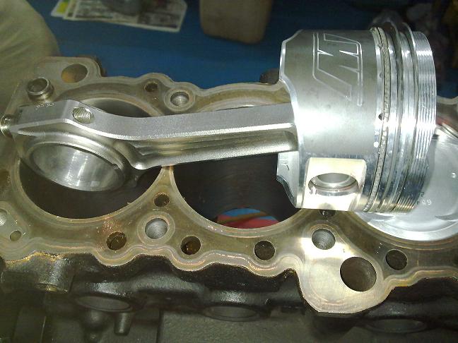

9.SCR Custom rod
10.Wiseco Pistons
11.SCR Stroker Crank

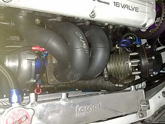

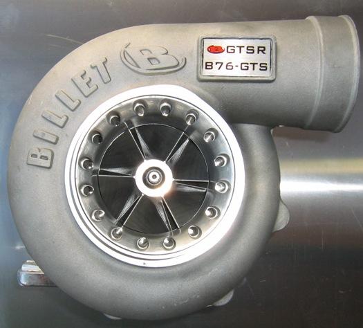

1.Custom Billet Turbo
2.Custom Turbo Manifold
3.Ceramic Coating
4.3.5inch down pipe
5.TurboSmart Waste Gate

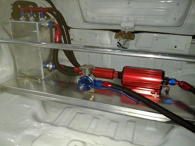

Fuel and Ignition System
1.Haltech Platinum 1000
2.5 bar map sensor
3.1700cc x 8pc injectors
4.High performance Fuel Line
5.Aluminum Fitting
6.Aeromotive 1000cc fuel pump
7.SCR custom Surge Tank
8.TurboSmart Methanol Fuel regulator
9.AVS spark Plug No 9
10.MSD 8.5 helicore Plug Cable
11.MSD Ignition Coils
12.65psi Turbosmart Boost Controller

T3 turbine housing for that kind of power?

T3 turbine housing 94mm exduser.The turbo can only boost 3bar max.Not big like your car.Your car still fastest than her.Not special project..just for fun and still learning for tuning.No 'haram' game.The owner Prepare for SDB 2010.Jo1 still the best...support Jo1.:top:

Not to say whose the best, just wondering can the T3 turbine housing support up to 750-850hp. The compressor can support that power with the 94 exducer but the T3 turbine housing will be choking point of the engine. It would be better off with T4 which offer more room for upgrade.
The compressor will outflow the turbine which made higher pressure in the exhaust rather than the intake that will effect engine life due to detonation and pre-ignition prone. Even with ethanol to overcome that, it a good thing to smooth the flow and maintain good pressure ration between the intake and exhaust.

hopefully BILLET turbine can prove it........with a good tuning & awesome weapon.....good luck in two o ten SBD.....:bandit:

T3 only small power,for billet just plug and play for T4 102mm exduser goes up to 950whp.Before, this car already 1.8bar 6++hp 10k rpm,he can't handle their car.I dont know What to Say when 800hp.But i love to shoot 200hp NOS with same boost level.Billet have CNC and custom the Exduser site.He can do .55 500-600hp with AR.50 at the front.Small Turbo HUGE Hp.And Daily Driving.

Billet turbo already prove for GAS Motorsport,Dyson Rotary and Turbo Bike.THis car already Champ with their group and street racing but noy try yet for SDB.Coming soon.
