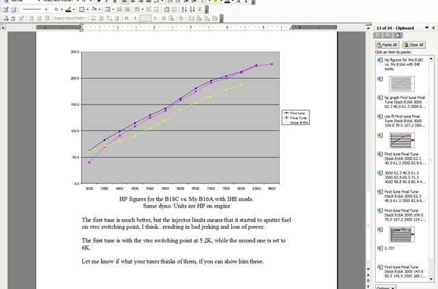

You know, chris of pentagon mentioned about having baseline dyno results before you mod your car.. I think he has a point, and I'm going to post a more detailed reason why I went and dyno a fully stock B16A with the stock ECU with just exhaust and intake mods..
So that's why I did for mine, and I posted the results on zth..
unfortunately.. the dyno reads mine a little high.. to high in fact, for a stock B16A.. in fact, I'm making power comparable to that of a stock 1.8. Dyno reads high? Possibly, but with 2.1L setup getting 190 whp (before) 210 atw (after tuning).. it can't be that far off, right? (on the same time and day I dyno'ed my car too)
Why did I dyno a stock car in the first place, you ask?
Well the reason I did it because.
a) I want to find out exactly how the stock B16A performs.
b) I want to find out how much power I'm making, and 'where' I'm making them.
c) I wanted to know if the mods I make did result in an improvement of a stock B16A that usually see about 130-140hp.
d) I wanted to see how well the stock honda ECU copes with improved intake and headers.
e) I wanted to know why is it that my car can keep up with a B18C on high rpms, but 'makan asap' when at low rpms.
The results..
The header and intake resulted in a lean mixture at high rpms.. plugs were whitish for a while, and I decided on the ghetto route of getting a type R regulator (which I know makes more fuel pressure than my stock B16A unit) I have to get a sard unit soon though.. but the blue/red color - blergh! Haven't seen a chrome unit yet though.. I know they're available.
That cured the lean mixture problem, but it killed low end power with it's fuel enrichment on low rpms..
So.. guys.. dyno your stock engines.. you might just find that your car makes pretty good power, and then you can decide your modifications.
The strange thing is.. I'm still getting good fuel economy. I suspect the honda P30 can lean out fuel mixtures, but cannot enrich mixtures unless it goes into 'limp mode'. I don't think they're capable of doing much though.. probably about 10-20% of fuelling adjustment for fuel economy.

i'm just being curious...how accurate is the HP reading from a RSM together with the G-sensor?...as compare to the actual dyno machine.....
Forget the numbers.. all dyno numbers aren't accurate anyway.. (for me at least)
Like looking at dyno sheets.. all those numbers mean nothing.. it's the shape of the torque curve that matters for you to decide your tune/upgrades.
What matters is if you made power.. and that's only measureable by acceleration times. And the thing that affects your acceleration times is the shape of the torque curve you get on the dyno.

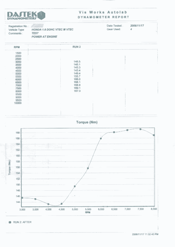

Here's a screen cap of what I'm doing now, I've been sleeping since 5.30pm just now.. :P
My lame B16A...
Torque at engine
143Nm/105.4lbs-ft/14.4kg-m on engine (worse than wira 1.6 oh!) at lower rev ranges... the inherent problem with having small displacement engines, but want to make big power.

You torque is weak,,,not good for dragging. Who tune your engine though ?
shiroitenshi
Apr 18, 2006
3,676
170
1,663
Tuned? hahaha.. seriously...
This is the stock P30 ecu... not chipped, nothing..
I just did it for the baseline.
You think I'll let other people tune the engine ah? :P

Nothing.. I didn't tune anything.. just HKS powderflow intake, Mugen, type R pipe and border muffler.. and 3.0 bar(idle) 3.5 bar fuel pres (at wot) with stock ECU.
