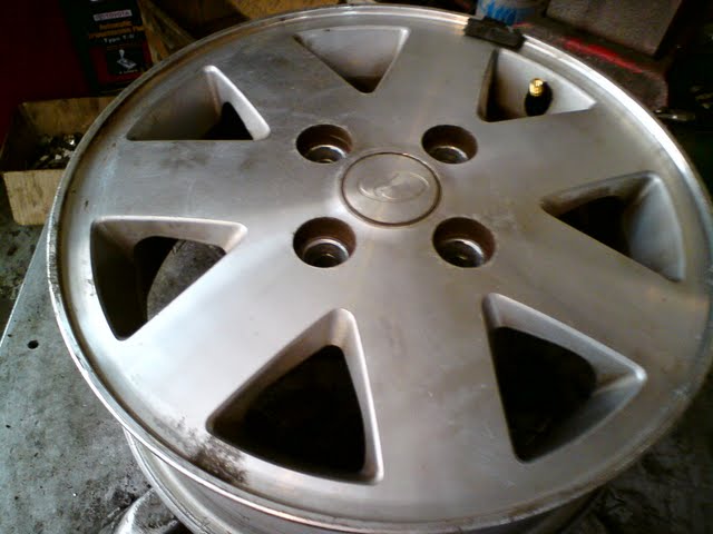

a damaged wheels

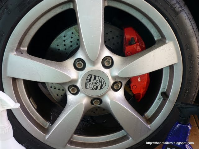

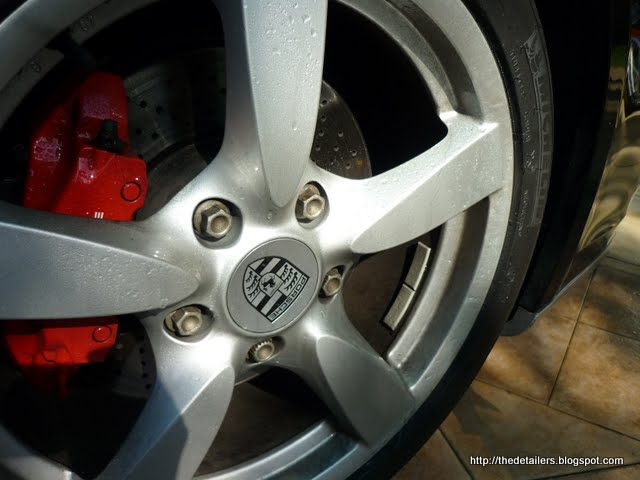

not too bad from a distance but...
The good news is maintaining yr precious wheels is fairly simple. You can ensure that our custom wheels stay looking good no matter how many miles they have on them by taking just 1/2 hour weekly.

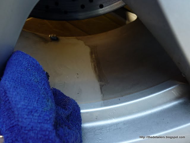

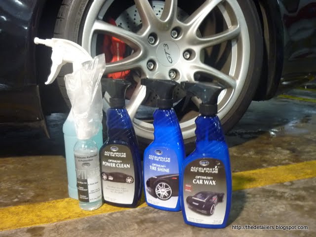

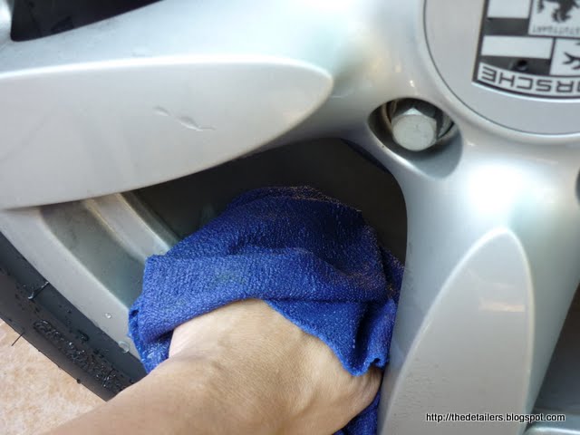

with micro fibers & ONR
wipe on wipe away

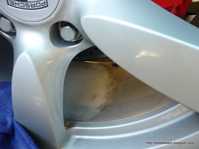

ta da
the dirt collected

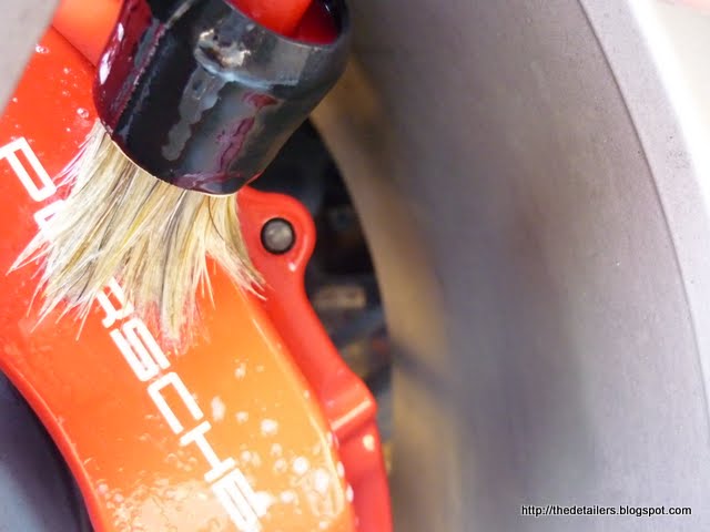

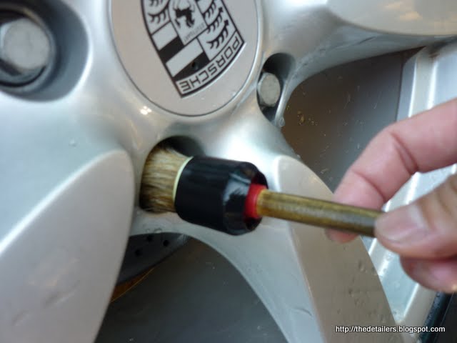

wheel nut cleaning with another wheel brushes
Har stains & brake cakes on brake calliper cleaning with Power clean

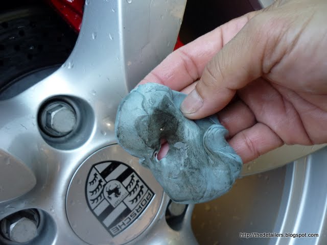

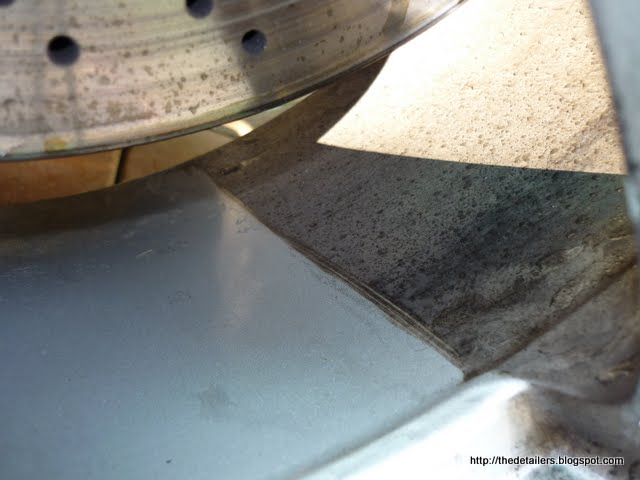

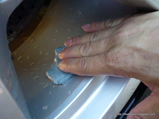

now claying the rims to remove TARs

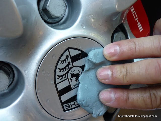

claying the outter area to pick up tar & road grim without using strong & abrasive cleaners....that may marr the clear coat of the rim
ta da what i picked up

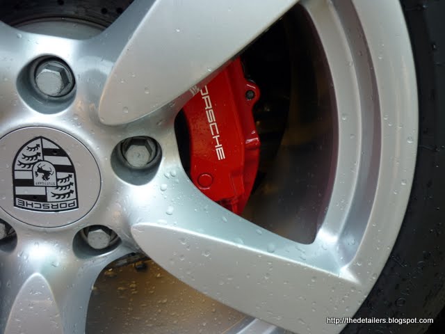

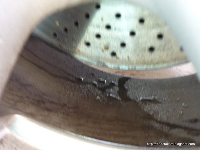

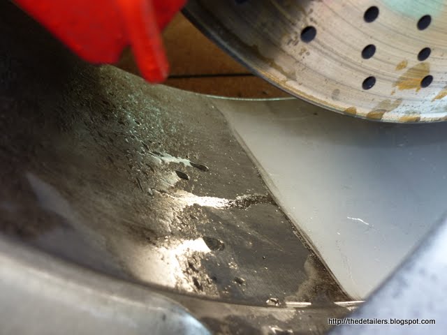

look at the dirt - brake dust -
ta da
look at the 50/50%

a damaged wheels
wipe on wipe away
ta da
the dirt collected
ta da
look at the 50/50%
