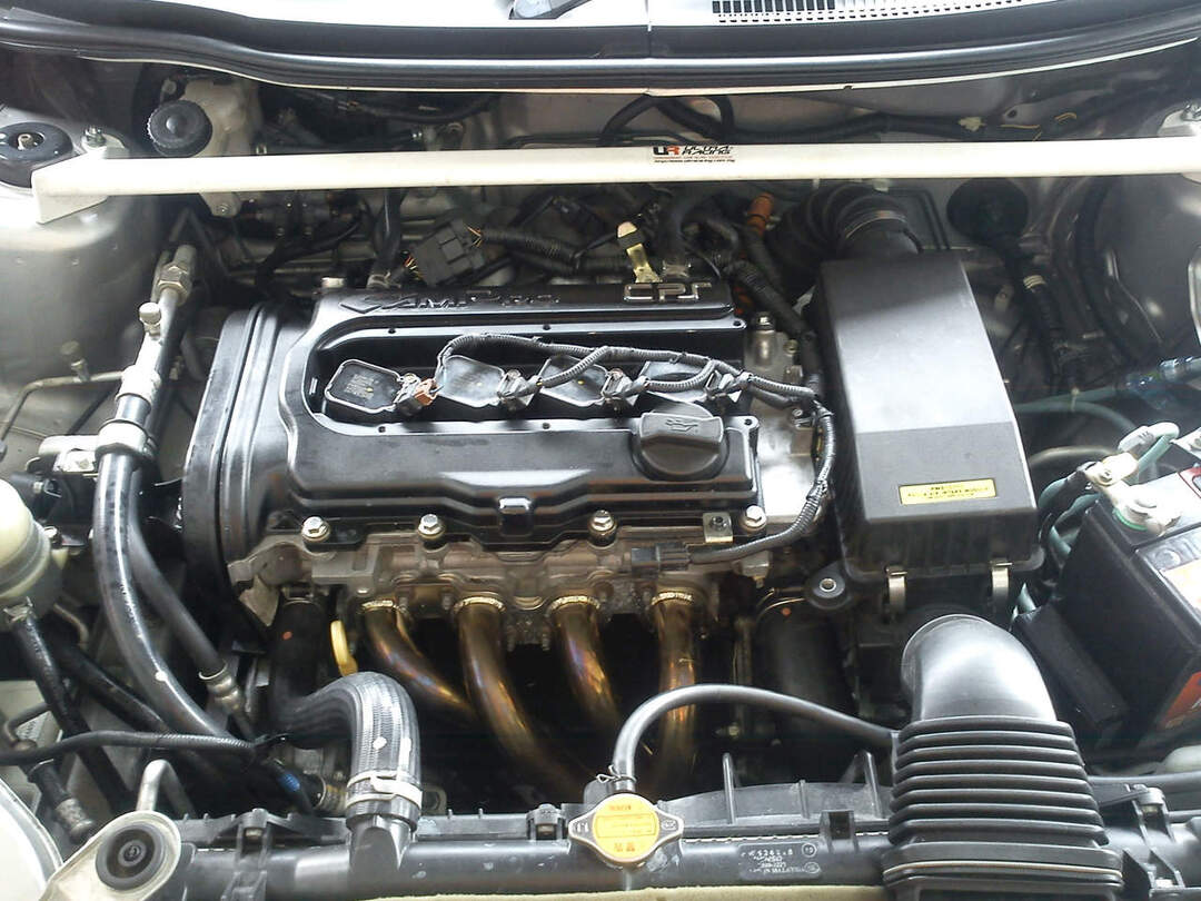

not to mention alot of speed trap cameras.... haha...
if i am not wrong with my current aichi kikai gearbox... can reach a top speed of 180km/h at 6000 RPM before it stops going anymore...
speeding on straight roads not fun for me (except need to chase a plane...)
i usually utilise this mod when going uphill to genting highlands... haha... can smoke quite a number of cars...:biggrin:
