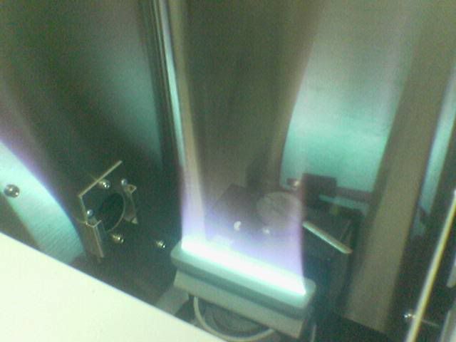

the purpose here is not to find some kemikal tat u can put in ur fuel tank or spray into ur intakes to remove carbon lar
i never see the point why to do tat, u clean now, once u start engine its full of carbon again. haiiiyaaaaa :mad:
Here just try to find the right stuff to remove carbon deposit oni
mebi useful when overhaul engine or can clean ur exhaust
remove carbon deposit kemikally :hmmmm:
bunsen burner is just same like ur cooking stove lar, not hot enough lar the gas
Need acetylene/oxygen gas flame oni can vaporise the carbon lar
flame like tis lar

i read from elsewhere mentioning the spark plug cleans itself under high temperature so i tot of using the penunu bunsen to burn it. haha....
CarroTT
Nov 9, 2006
177
3
under high temp and high pressure lar
if just simply burn it in normal pressure, u nid veli hot flame
but then if u use acetylene torch on a piston, ur piston will be cleaned, but later i tink not useable animore ler . . .
quik guys, tink kemikally
dun simply use force or heat or eletricfy it

bro tried H2O2 yet???
i can't.... my gf used other subtances can't proceed.
using acetylene torch??? siao ah???
later find piston & valve cair....
Northiswara
2,000 RPM
Dec 21, 2005
2,589
7
later on piston head got lubang!
haha................
i still prefer the traditional style.
use brush and diesel.
