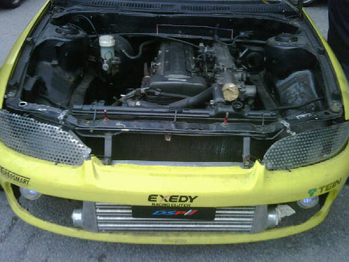

anybody know where i can find more information about this sleeper......FWD proton....damn awesome:driver:
thats not sleeper or road legal car la.....no lights...probably drift car or track use only...try google for satria drift speed city kl......
if thats the case...waja oso got install silvia engine and drift....and i saw a few satria/wira body with subaru engine inside... :biggrin:

still not the finish product la...no piping to ic
the tengku djan's waja sr20 change whole floor to make it happen
need serious job on chassis la...terbarai kang
Look carefully. That's a chassis built around the engine. It probably has a frame built then the Perdana shell bolted on to fit that engine.
money will flow like a niagara fall you know.....haiiihhhhhhhhhh...
If he can talk about a Nissan engine in a Proton, he's got money. Why you worry?
Got the $$$, what engine goes in what car also can......:biggrin:
