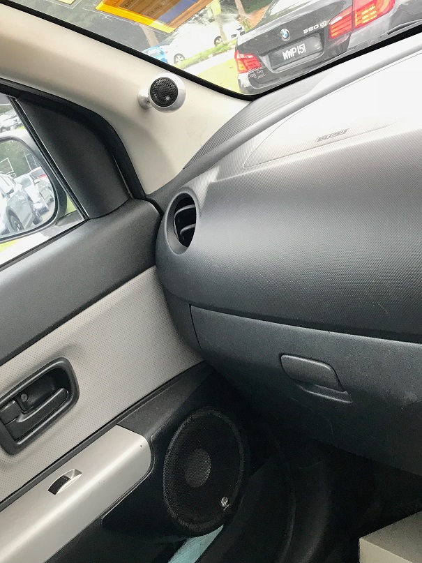

Based on what you have now - I think you can do better la. Come compare your sound vs my Myvi sound. I only have component speakers with stock player and under-seat woofer, no amp. The sound is pretty impressive for the amount I paid for it (RM1k plus a little) and my mid-bass speakers are custom fitted to the door. It's been with me for almost 8 years and still going strong, except the stock Myvi player. The buttons are committing suicide.

This is my setup hooked to my stock player and an underseat woofer. That's it.

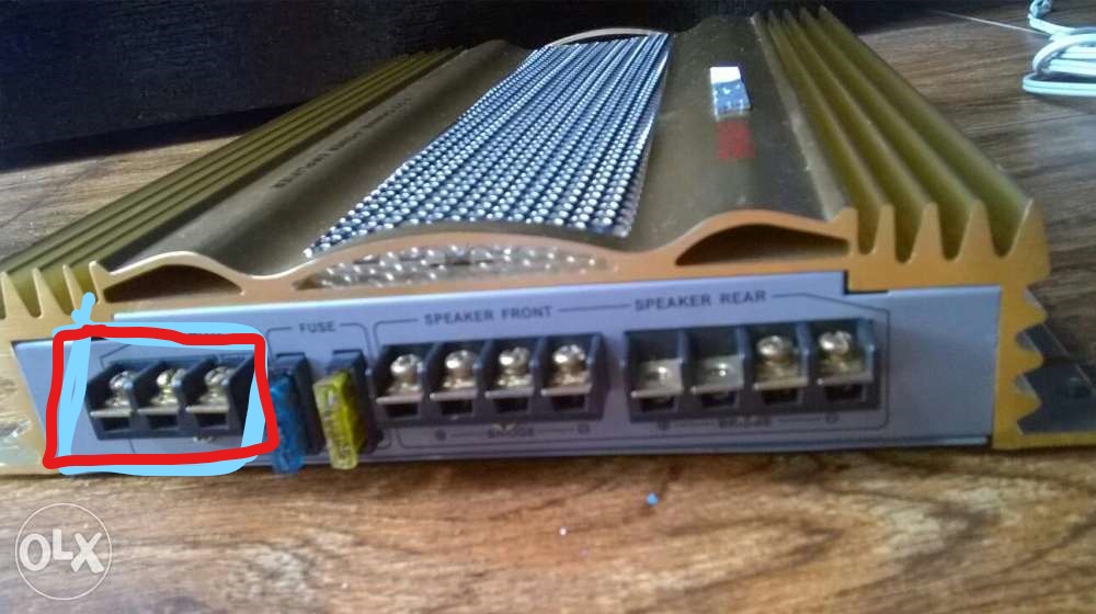

well its already done by make new hole...now im wondering about to install preamp... can i loop power from power amp to pre amp?? or do i need new cable..please refer to picture

You can but why would you need to? You don't need a pre-amp la. Those are most of the time a waste of money.
yea i know ..HU already got good equlizer..but my setup is dash board and rear door speaker direct from HU. while my boot shelf speaker powered by power amp for only bass out..so if i setting bass from HU then my dashboard and rear door also play bass which cause distortion something like that...
what i want to do here is.. i want install pre amp only for my boot shelf speaker ( which is only bass) for allow certain bass band frequency only.. so i think it will be more clean bass from the back..furthermore i can turn off bass from HU EQ..so my rear door and dash board speaker will play only midrange to lowest mid range frequency...how about that master..tell me which part im wrong here include guidance..
