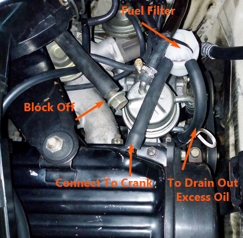

This is what what the workshop did for me this afternoon. Fixed a white color plastic fuel filter. One tube is connected to one of the outlet at the valve cover, while the other outlet is fixed with a hose placed facing downward, to drain any excess oil should it get full. The outlet from the air filter case is now blocked off. Is this the right and proper way to do it?
You can do it that way but instead of venting out to atmosphere, should connect back to manifold, the fuel filter will act as filter. When filter is dirty, just change it. I am doing it on both my old VR and old Hyundai....lol
I remember adding a mini breather in the middle of the valve cover too to reduce the pressure. I can't remember! DAmmit

Could you enlighten me. As I am of no car enthusiast, why suddenly my old car has this problem? All these 20 over years, I do not have lubricant in the air filter compartment. I suspected the one-year old overhaul job is the crux of this oily issue. I am also told by other car mechanics, there could be problem with the piston ring.
When most people do a "full overhaul", the head is usually skimmed a bit so your compression is higher. I don't know if they changed your piston rings so assuming it's a proper full overhaul, those piston rings would be changed so blow-by gases wouldn't be the cause of your oily situation.
For emissions purposes all cars usually recirculate the blow-by back into the intake, so if that blow-by is oily, it'll just gather in your intake and result in lots of oil vapour and all caught in the filter or intake area. A higher compression also partially contributes to more pressure in the system aggravating the whole vapour situation. That's why adding a oil catch tank (or in your case a cheap petrol filter acting like an oil catch) stops all that oil vapour from recirculating back in to your intake.
Regarding the piston rings - full overhaul should have replaced those rings. If he's saying there's a problem then you better question the mech why wasn't the piston rings changed in the full overhaul. If it's just a top overhaul then those rings wouldn't be touched. A worn piston ring will usually have bluish or blackish exhaust smoke because of the engine oil burning off due to the bad seal from the piston ring.
