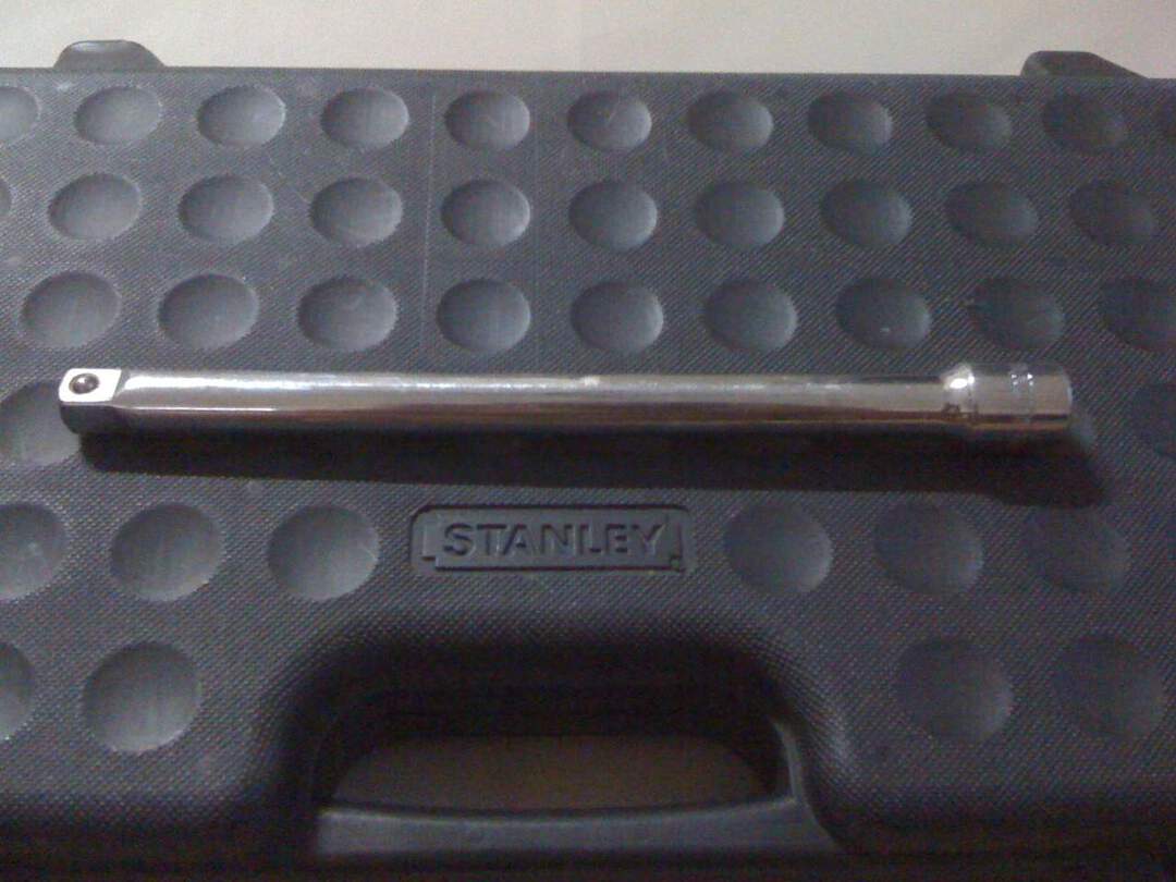

u want to change to taiwan smoked headlamp or u diy spray it??
i got use the taiwan depo smoked headlamp...the light reflect not good la..but high beam is ok..only low beam not good :banghead:..i adjust the lamp high and still cant c the road properly..
attach pic show the long bar to reach the bolt at 50cent coin hole..

yep..thats about correct length for reaching the screw.....
