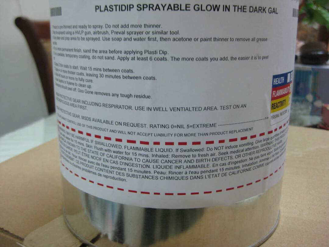

wyldemdd : What proportion of xylene / naptha / toulene to the PD?
50:50 ratio = if the PD is 429ML then you need to mix 429ML of xylene/toulene/naptha. You can go for 60:40 ratio but eventually you need to do more coat since the PD is thinner in it's form.
