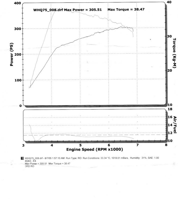

jinkl,
Good sharing ! and 301whp on stock e3 is damn high !
Can share how much you boosting to arrive @ 301whp on your e3 engine on dyno ? Stock specs for e3 is at 276ps @ crankshaft so that should ard 230whp.
U using 1.5mm gasket ? And i suspect u got a good ecu to go with it..hehe. Are you ?
heres my dynograph
stock head and block(no port polish or lighten crank)
stock turbo
custom made manifold
hks 272 cam
hks twin power
1.2mm metal gasket
sard fuel regulator
arc intercooler
apexi power fc
560cc injector
walbro 255 fuel pump
etc mod racing plug,racing plug cable,exhasut and so on
