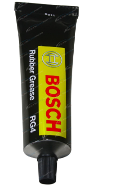

1 thing that very important to do while replacing brake pad (which most mechanic never do) is to lubricate both the caliper guide pin with hi temp silicone grease. This to makesure that both inner caliper (piston side) and outer slide evenly whenever u apply brake. I just killed my brand new jun e-slit rotor n bendix metal king when only the piston side pad totally worn out and scratching the rotor but the outer side still very thick.

Guys what about greasing the backing plate and metal to metal contact points with copper antiseize ?
Is that necessary ?
Is that necessary ?
not absolutely necessary but it helps a LOT in dissipating heat, even force distribution (to some extent) and overall brake stickiness (sorta).

Yeap, that's right guys.
We should clean the caliper pins so that it won't seize up.
Later didn't clean will eat one side of the brake pads
