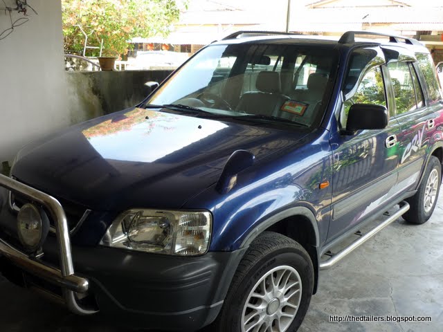

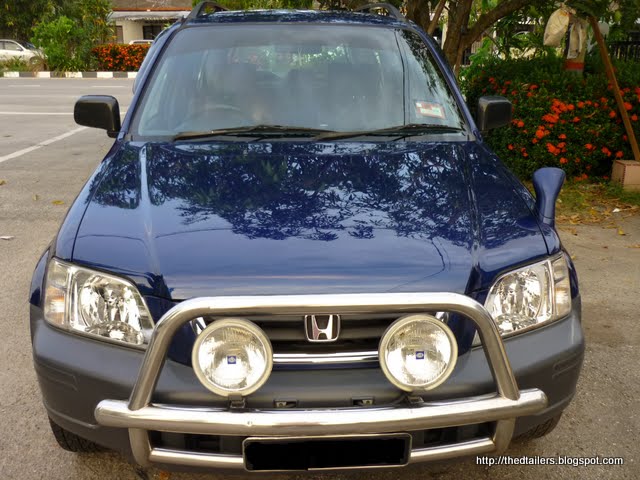

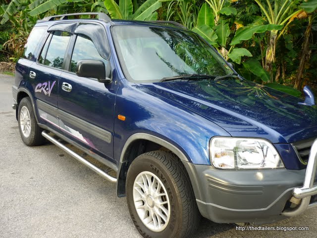

as eraly as 7 in the morning, went out to bring this 14 years Honda CRV back, this is was one of the SUV everyone wil eye on during that era, probably car theft would also like - as it was very demanding)

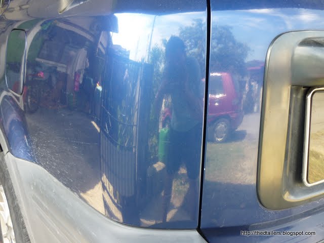

but now, like any other Herbie...story....a sight miss turn..a loose nut that cos the engine leak & failed....trun this into quit a junk yard situation

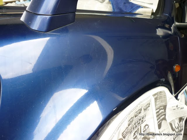

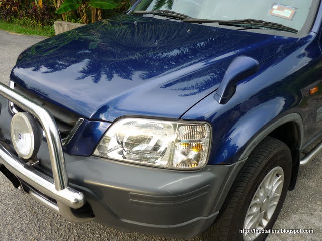

blogger advise..pls pay extra attention to the left front fender....

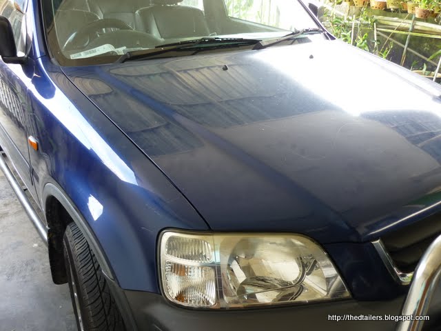

not too bad...the paint look abit dull

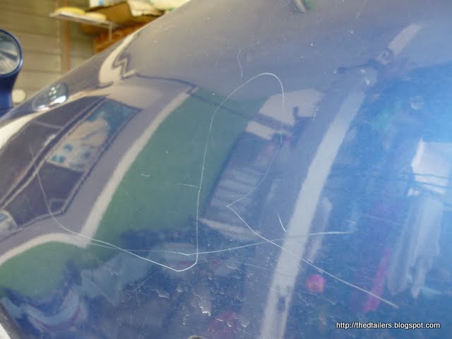

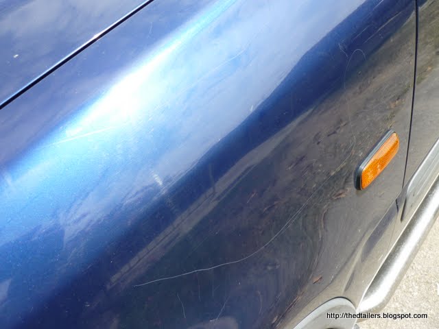

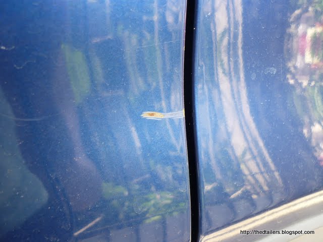

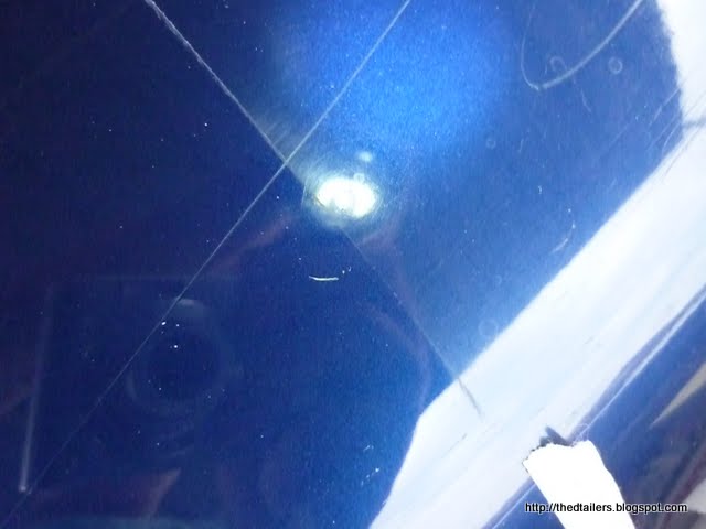

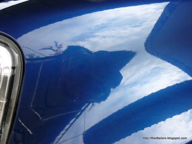

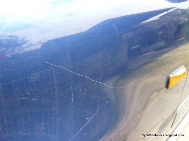

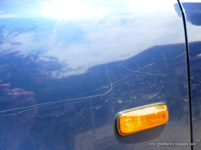

ANOTHER IDIOTIC VANDALISM
this is probably sign by 'the mask of Zoro' with a sharp & pointy objects, which cuts through paint
annotation
in Malaysia - there is such a thing called "teach you a lesson" where the robin-hood of the street will give u scratched on your paint if you unintentionally obstructing others or some may even do it out of jealousy (or revenge as they have got it from others) this irresponsible Hooligans who's itchy hand will not sleep till they scratched some body cars.
You dont know how heart sick to see this on your own ride (speak as one of the victim)

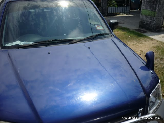

since the condition is so bad...lets send the car to road side washed ( thanks to the cheap & good labored contributed more to this paint)
NOW would you buy this at a premium?? no body would like to eventake a look anymore
unless something is done about it
DOOMED & MUST SENT FOR REPAINTING..........only new coat of paint ...only if i knew how to repaint ...only i knew not to park & get scratched by some irresponsible Hooligans who's itchy hand will not scratched my ride

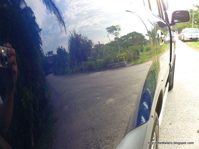

MY DEFINITIONS NOW is to get her corrected & detail to this

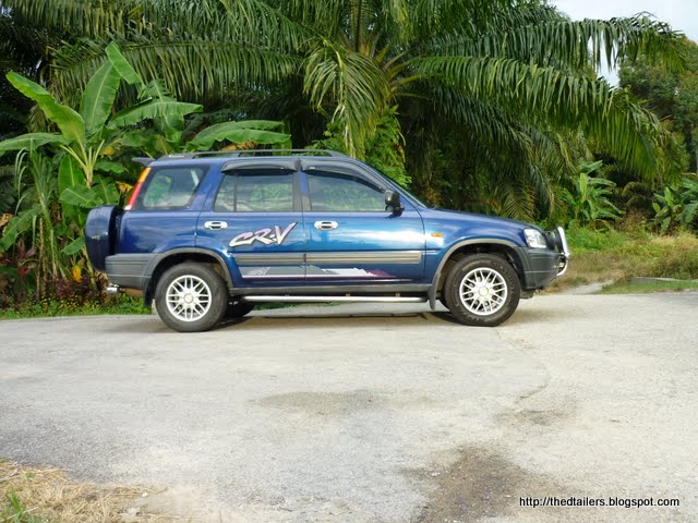

this is one of the after pic

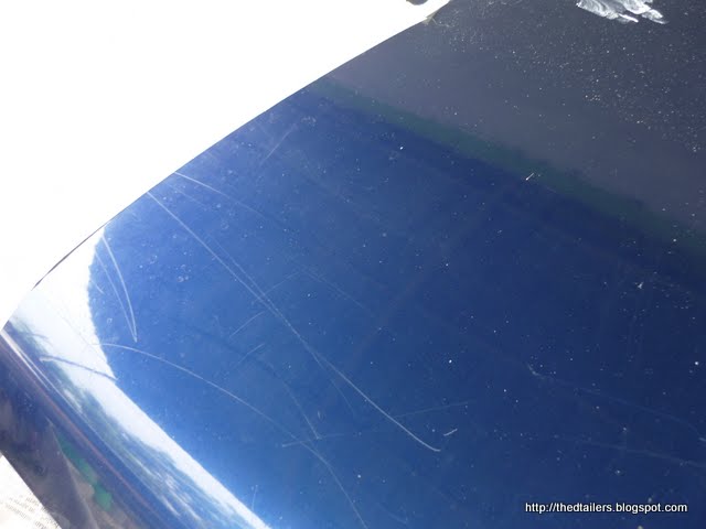

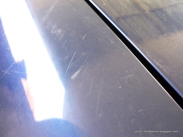

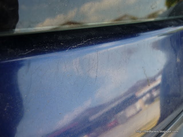

more damaging pics
more heart sick
more abused pictures
just simply more pics that invites butterflies into your stomach

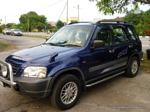

My uncles in law, always wanted a SUV, got a relative, who happend to drive this in KL city (2 years ago when they got this) you know the rest of the story...vandalism
they have decided to send this to repainted but somehoe it was delayed
till i found her
dont she fel like herbie when she is down & out

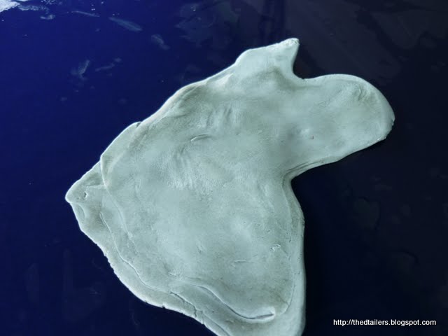

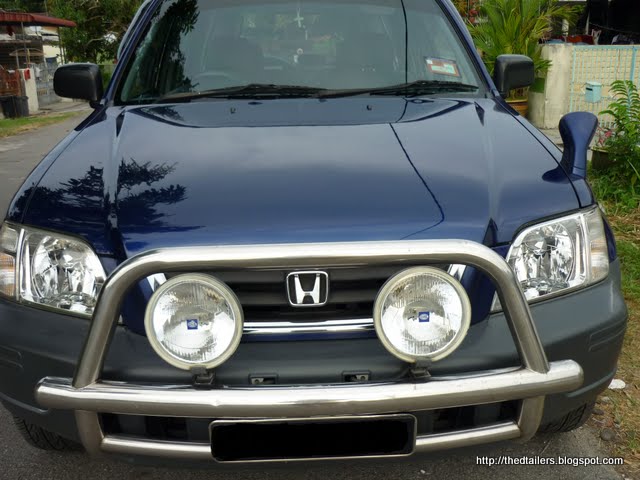

clay began ONR as lube...diluting 2 ounces with 500 ml of water & sprayed for more lube
my intervention plan

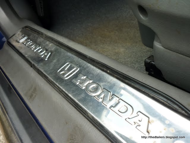

Osren Multi purpose cleaner with assorted brushes to cleans emblem & hard stained area
Optimun no rinse was as Lube with mild clay
Quick wipe down with ONR rinseless wash & 2 micro fibers to dry

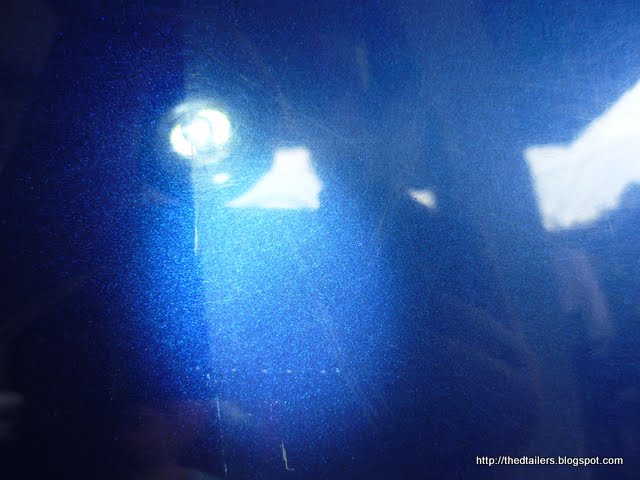

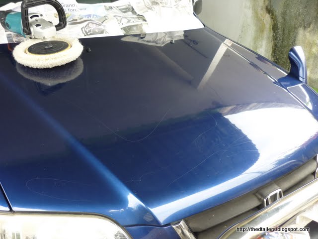

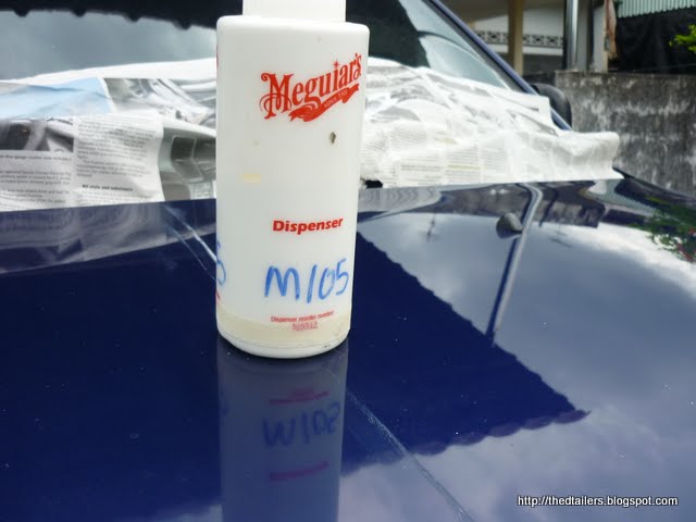

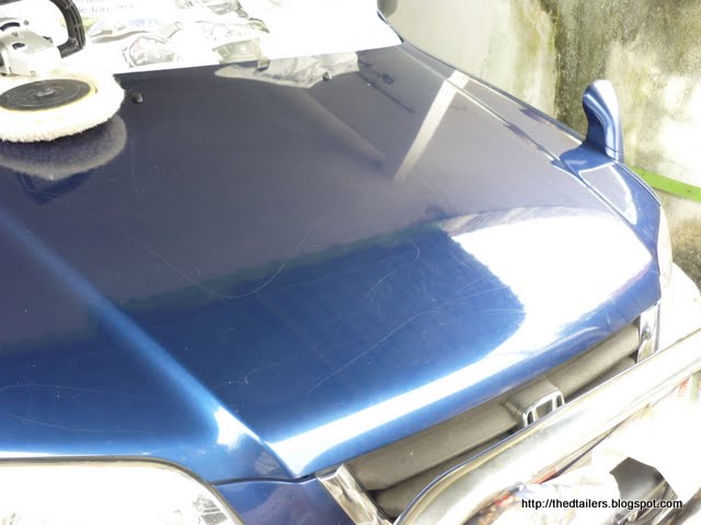

Paint correction - Megs 105 with double sided LC wool on rotary start
speed 600 to spread, 1700 with gradual movement & speed (repeated on some severely scratched area
then step down to
Rotary with Lake country Yellow colour cutting foam for removing swirls & Random Deep isolated scratches (RIDs) with Meguiars M 205 SMAT polish ....speed 600 to spread, 1400 with gradual movement & speed , finishing off at 1400 with moderate movement
paint polishing - rotary & Lake country polishing foam pad at speed 600 to spread the products & Speed 1000 move moderately with pressure & backing off to speed 600 with light feathering off

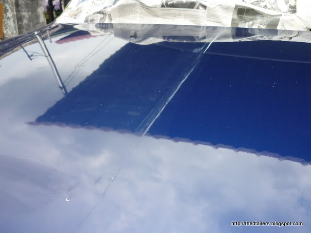

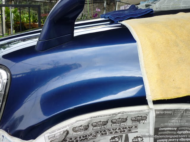

all plastic trim is wrap by news paper....as i did not expect such a heavy correction work...to prevent compound / olish splattered & stained any plastic or rubber trims

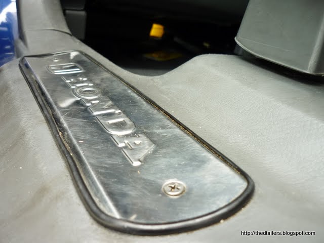

wracked side steps

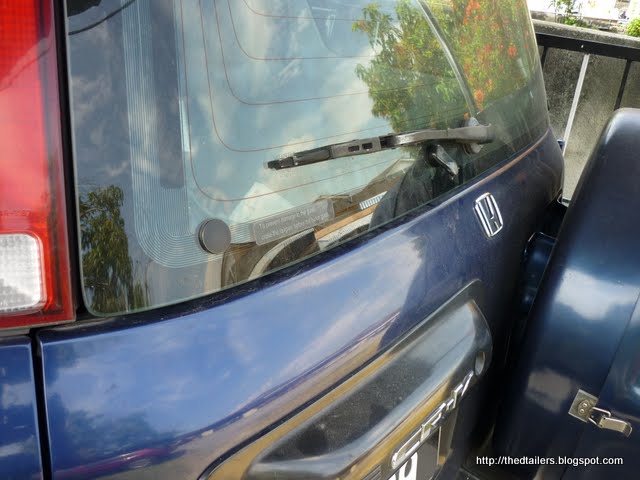

BEFORE -
AFTER

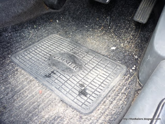

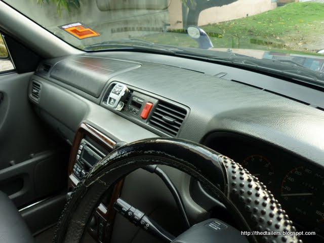

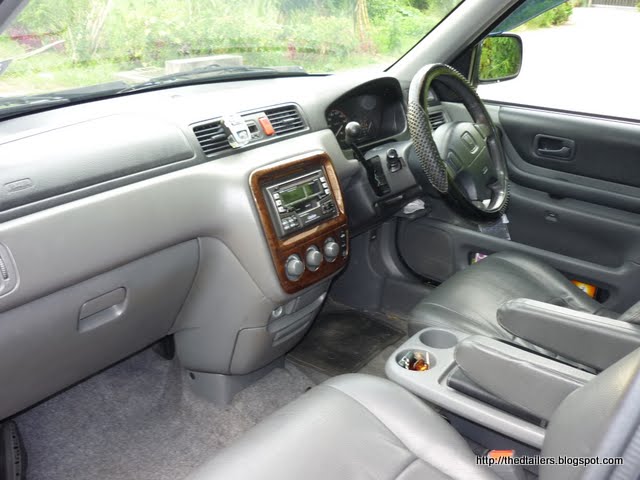

after interior MPC brush off & detail by gold class

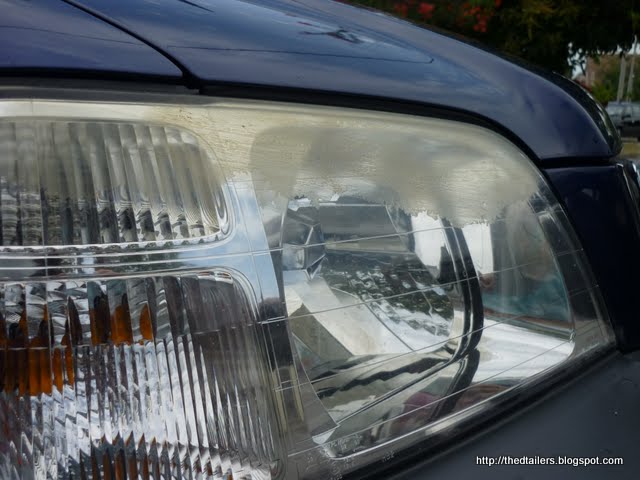

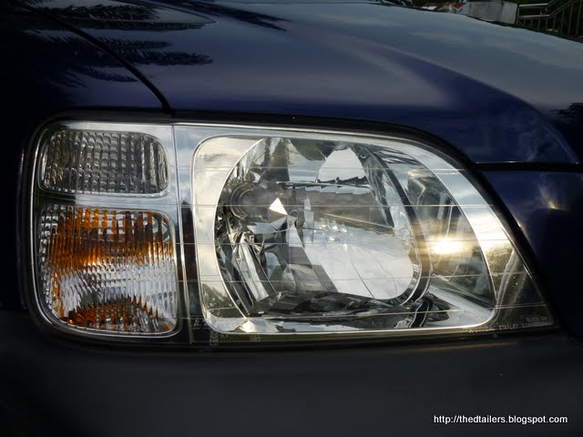

Head light oxidized & many workshop would asked you to change
after sanding down - M105 & followed by M 205

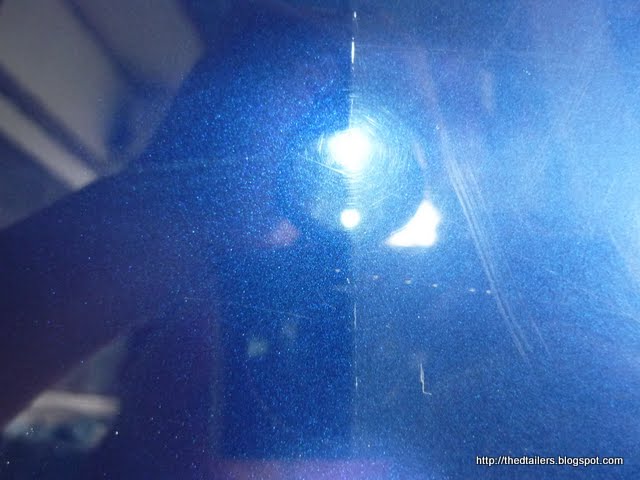

1st 50/50% SET
50/50%
50/50%

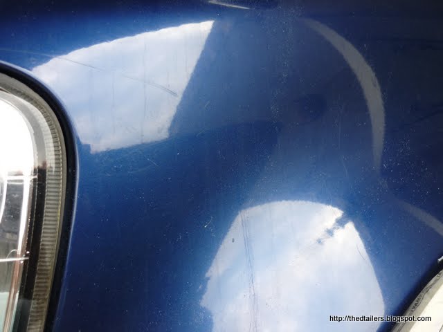

ANOTHER 50/50 AREA SET FRONT FENDER
50/50%
50/50%
al oxidation removed

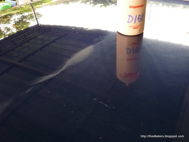

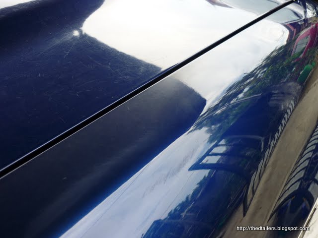

but some RIDS & cut need additional passes to bring the level down
ta da
REMEMBER BEFORE
Now AFTER M105 & M205

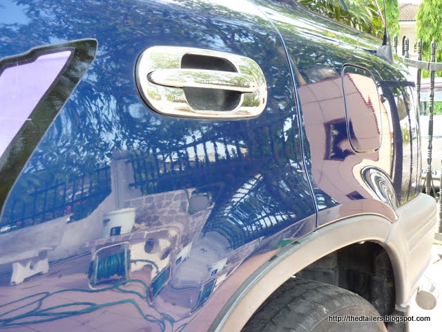

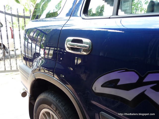

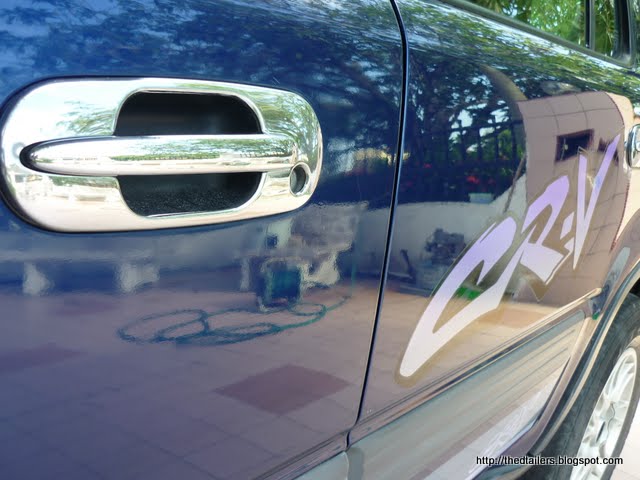

DOOR HANDLE AREA BEFORE
now..better than new

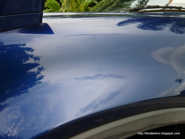

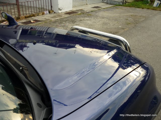

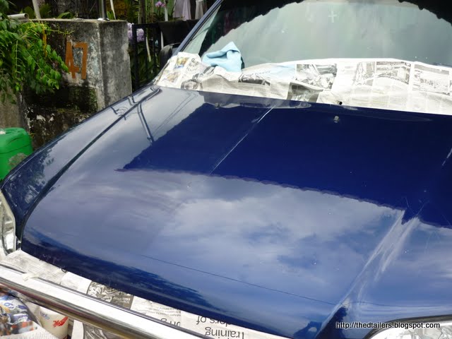

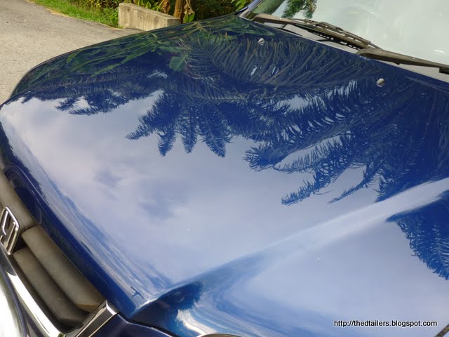

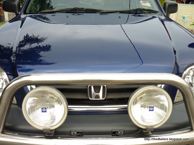

FRONT BONNET 50 /50

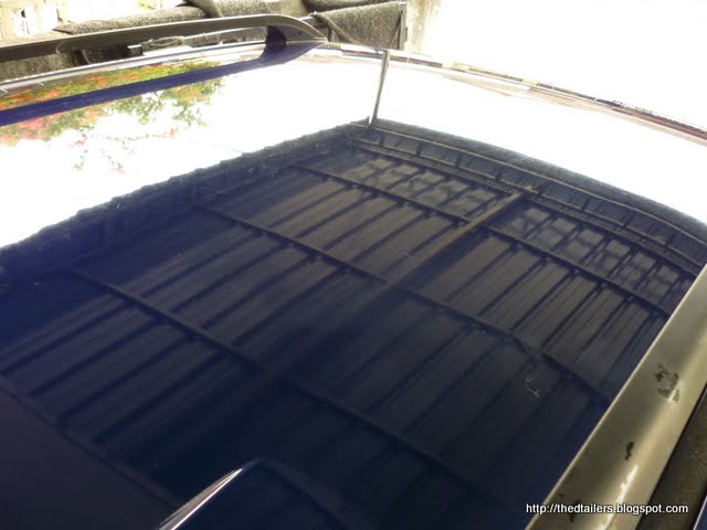

ROOF 50/50%

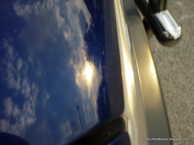

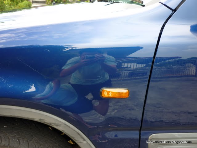

BEFORE RIGHT TOP OF SIDE FENDER BETWEEN HOOD
BEFORE

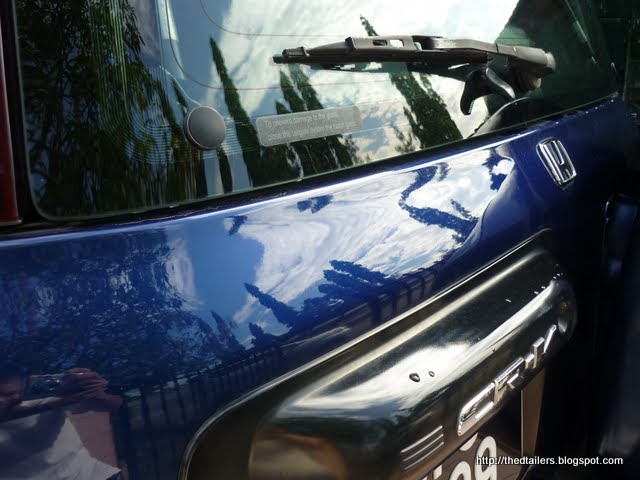

AFTER m105

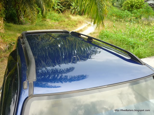

after m 205 & complete restorations
some pics
JUST BEFORE RUBBER HITs THE ROAD AGAIN

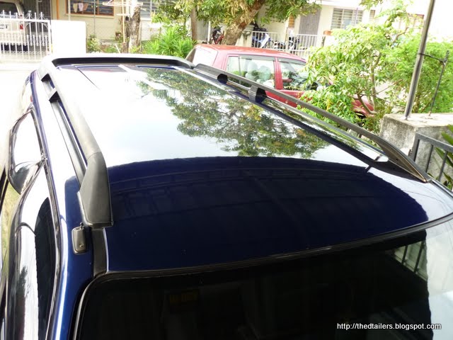

remember before
paint look so dull & unattractive
if this ride where to send for repainting

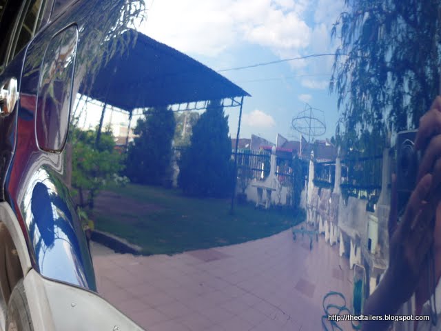

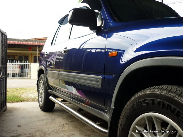

NOW THE LEFT SIDE RESTORED DETAIL
remember

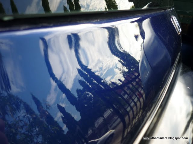

AFTER REAR BONNET
remember the mask of zoro?
before

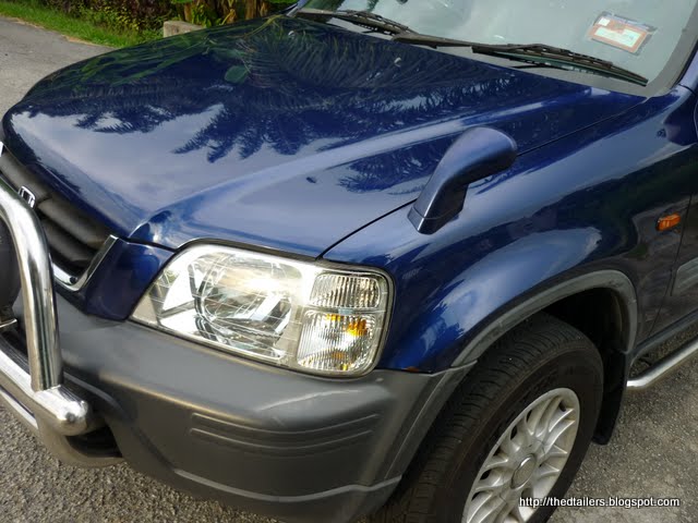

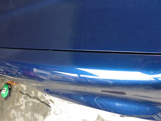

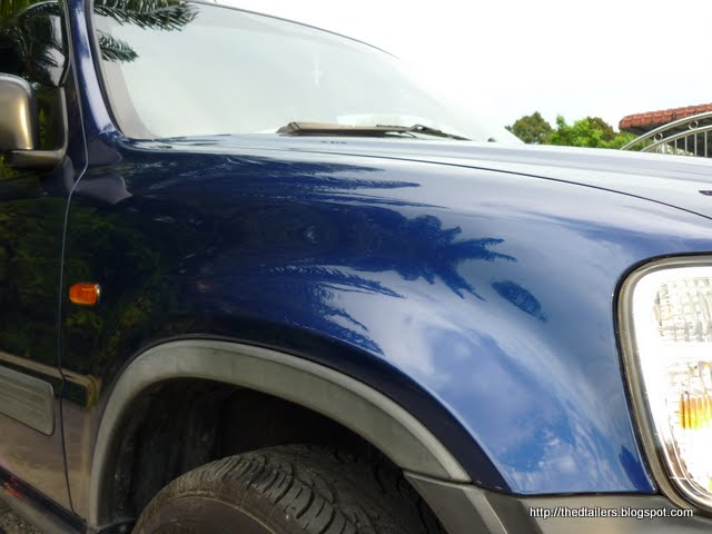

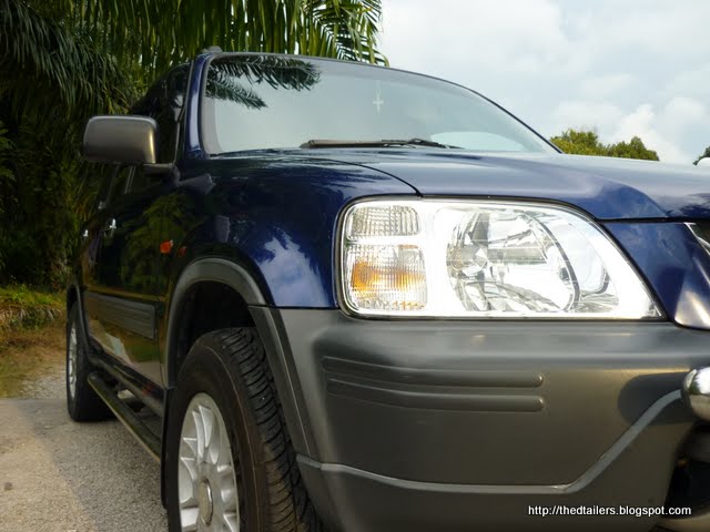

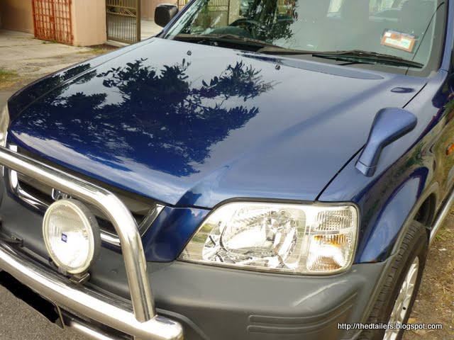

AFTER FRONT LEFT PANEL
did u pay extra attention to the left front fender....???

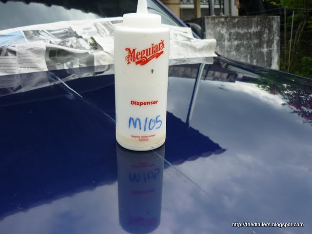

then step down to

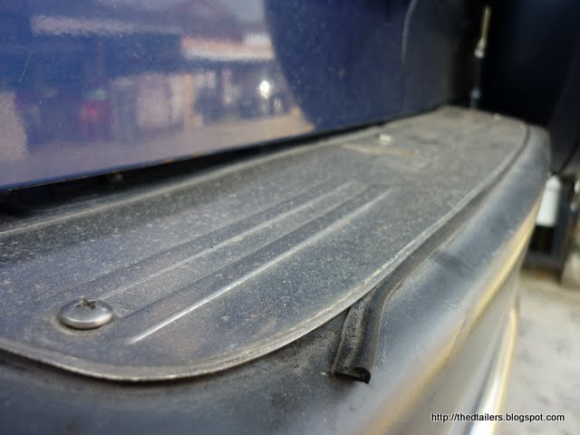

wracked side steps
BEFORE -
AFTER
ta da
REMEMBER BEFORE

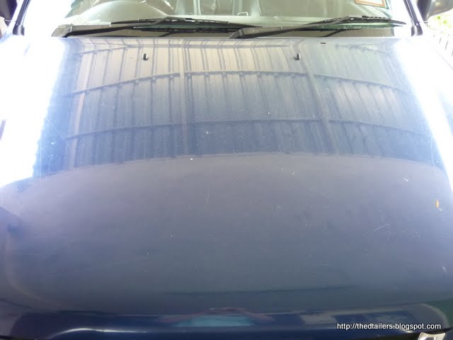

FRONT BONNET 50 /50
ROOF 50/50%
BEFORE
AFTER m105

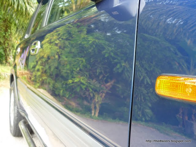

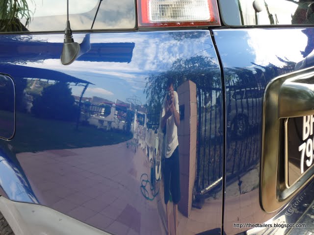

AFTER REAR BONNET
