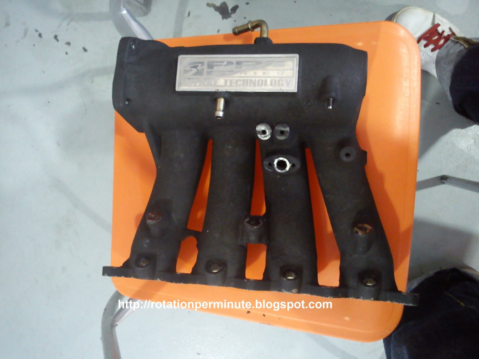

nice. just like what my mech did to my 93NA. fit in the b16a intake by port match the hole with the cylinder head. cost around that also.
now, since i convert to mivec head, i'm using std intake back. but now, collecting money to fit in skunk2 intake in my mivec. my new mech suggest me to cut and weld the intake with mivec's intake. not port match.
so, are there pros and cons with cut and weld method?

The aluminium weld will be the most important part. And if possible add support if not
due to vibration of engine and gear shifting will cause the join part to crack and leak air...

the performance is better than using gsr intake..but not as good as skunk or b16b.. just port match the head is a better option and more cost effective..hehe..below rm100 kawtim.. but if using the skunk intake need to weld a bit to match the 4g9x screw holes

yes can use ur 91 TB back... u will feel better throttle response wit b16 intake.. much better frm std one...easy rpm raise... dun forget to make bracket to support ur intake like me did... to prevent vibration to the intake n crack the welded spot... :)

Hi frenz..just to share my Diy :stupid:b series intake can fit to 91,92,93 single or doch head.Mivec also can la.i'v make alot to my frenz..juz want to share Diy...all circle hole must reweld back coz not realy match,specialy hole 1&4.than match port with gasket head la...then recut and some must topup weld to make the flange same like gasket use than port for look like ori.drill stud hole,skiming flange face.the last is to make munt for acesory like coil,sensor,cable,T.B(match port) etc. i prefer to use feul rail B series back..want to look cun use from EG.than polish until shine...but if u use 93 injector.the rubber injector oil ring at B series must port coz to fit...to make like this more coz la..but good match port and look like ori fit....but if my frenz want look more ori..then i make like this red wira terus dia puas hati:hmmmm:
