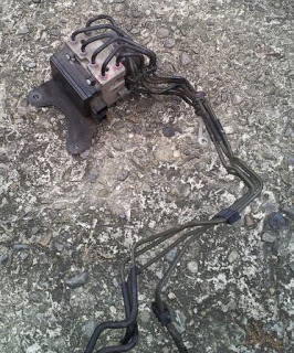

your main thing is this...similar to this...
http://www.zerotohundred.com/newfor...4787-ae111-toyota-corolla-abs-brake-pump.html
brake line maybe need rework...originally this thing is located near driver side head lamp...and then come the sensors...i never seen one first hand...so i dont know what they looked like or how they are attached together...

the servo also a bit different from mine..
coz i juz saw a fren's ABS servo with extra hose/wire coming out of it :hmmmm:
haha.. i think it's safer to buy a halfcut & take all it's braking system than to buy parts 1 by 1 :biggrin:
