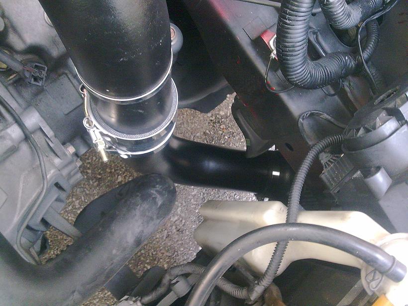

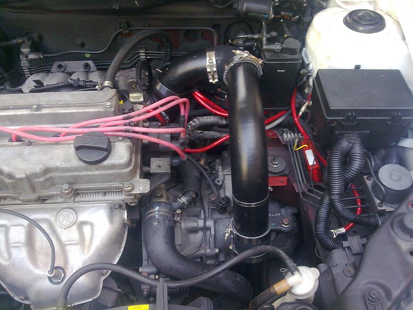

OK, I decide to remove the air box and just go with an open pod. The longer pipe really boost low RPM torque while retaining high end flow. Have yet to insulate the pipe so it gets hot. Going to get some ceramic fiber wrap to insulate it.
I have remove the fog lamp and the hole is used for the air intake for the open pod.
