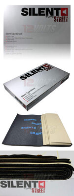

Personally I'd consider Silent Coat sponge then for the dampening bit, use anything like Dynamat or whatever you can do. The SC sponge seems to work really amazingly well to cut out mid to high noises.

Thanks izso for the recommendation. Will consider this too. I did consider dynamat extreme and contacted few direct seller but either it's out of stock or no reply. The price is around stp gold/bomb too.
